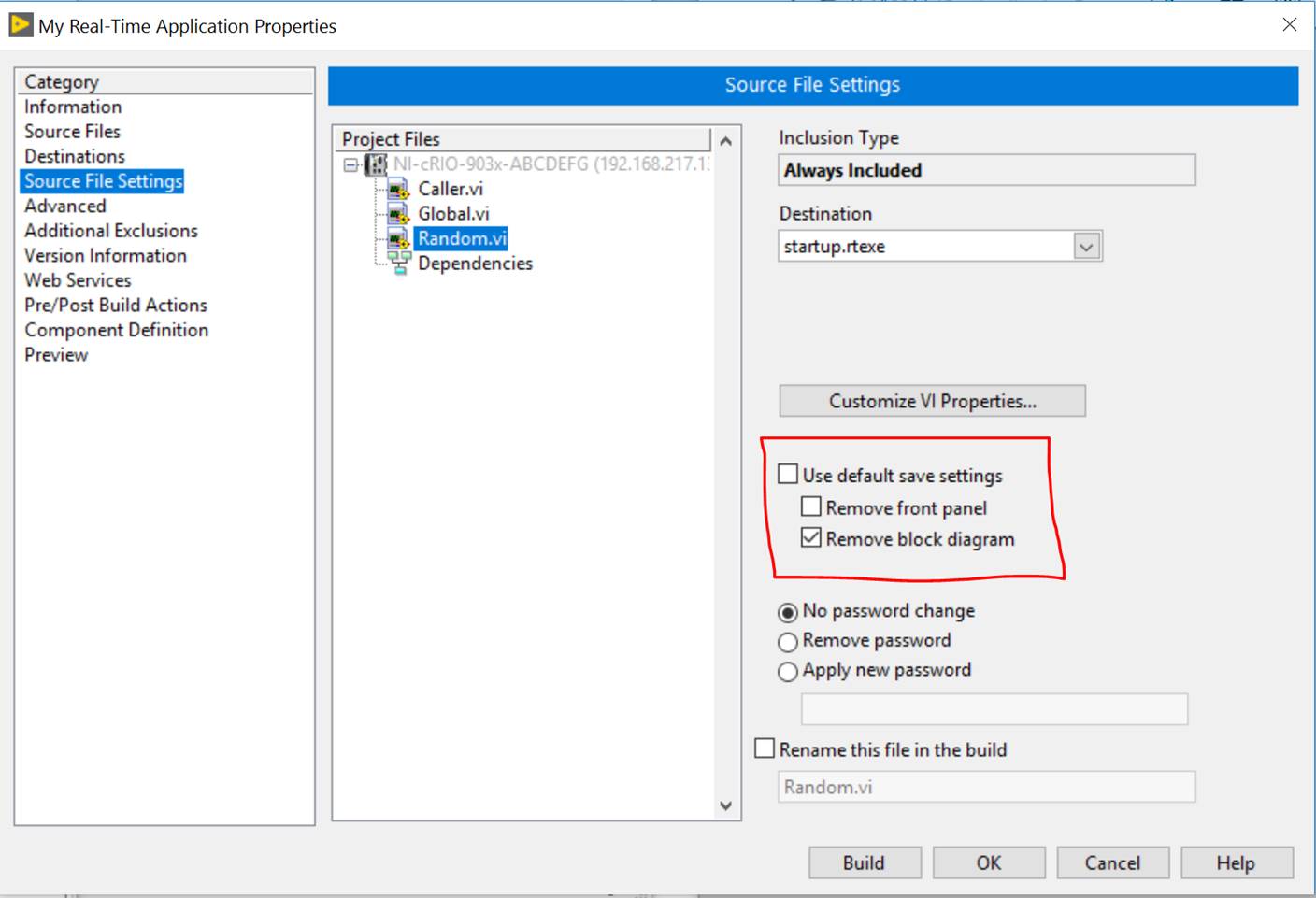

We continue to investigate. An R&D suggested workaround:
Modify the build specification "Source File Settings" to not remove the front panel.

That does sound like a pretty good and straightforward solution!
Thank you Fabiola and R&D I will try it!

Thanks for the hint with the build specification. I tested the workaround on our cRIO system under the same circumstances as last time. Unfortunately, it didn't work neither. It made no difference if I unchecked the "remove front panel" option for the whole project, or only for the DQMH-module.
So, we will probably stick to our workaround and make a template with them.
