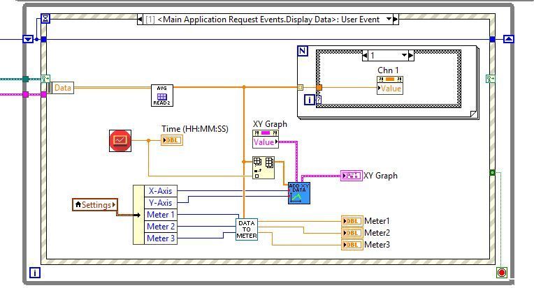

I am dealing with a problem of a delayed update of my data to my UI.
Currently I have my data acquisition sending a request event to update display each time data is acquired. I am using the DAQmx Read function in a helper loop acquiring data and sends the data through the request event. I have a helper loop in my UI module which is registered to the request event and only handles displaying data to the user. This is used to separate user interaction from the update of the display.
The test user has noticed after about 10 minutes of test time, acquiring samples at 10 S/sec, there is a slight delay in updating values on the UI.
My first thought is that the event queue is building up, and causing a delay. I tried to send the update display event at half the speed of the sample rate. So if the user was sampling at 10 S/sec only 5 events/sec were sent. I still logged at the 10 S/sec rate. But the user noted that it actually caused the update to the display to delay even longer.
I know that a broadcast event is popular for updating data on a UI, but I do not believe there is a way to control how often the UI modules listen for broadcasted data. I would like to separate the UI update rate from the other data acquisition functions. I figure update the display faster than about 5 S/sec is overkill for the user.
Any recommendations or tips on improving the communication between modules?
Attached photos are of:
Data Acquisition Helper Loop
UI Helper Loop
Data Acquisition Helper LoopData Acquisition Helper LoopUI Helper LoopUI Helper Loop

From the images I would suspect you are throwing enough points at your xy graph to make it a long time to redraw, possibly combined with your use of value property nodes which will block while the UI thread is redrawing the graph.
I second Dr. James Powell on this one.
On further inspection, it looks like removing the Value Property node would help.
More information on the difference between Value Property Node and Local Variable, check out this thread: https://forums.ni.com/t5/LabVIEW/local-vs-property-node/td-p/321755
If you are still having trouble after removing that property node, see if you can share the code with us, there might be other road bumps in the subVIs that are processing the data.

Thanks for the information on the performance issues with property nodes. It looks like if I would have used VI analyzer on my VI I would have caught it also.
We are no longer seeing the delay on the UI after removing the value property nodes. Thanks for the help everybody.
