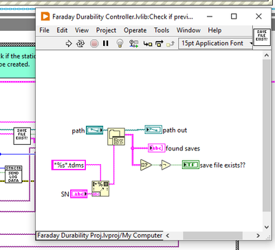

I’m having an issue with a DQMH module initializing a secondary module which causes my FP to freeze until the load is complete. Once the secondary module is launched and sends its "did init" broadcast, the main module performs a check for previous save in the main module's MHL.  During this process, the FP freezes halting all user events being handled by the main module’s EHL.  Once the load is complete, the main module's EHL then reads all of the events sent to the main DQMH module and updates the FP very quickly.

When a station is enabled, the durability module launches the station then waits on the init of the station to self-enqueue a durability message to launch a load previous save routine in the durability module.  Note, the loading of the previous save is done in the durability module's MHL and not the EHL.  I originally had the loading in the EHL and I was freezing the FP since I blocked execution of the EHL from reading and rebroadcasting the ai data.  With the MHL doing the legwork of loading a previous save, the EHL should be free to continue to send data to the FP and my station submodules However, that is not the case.  Below are some images of the block diagram regarding how a station is started and what happens when the "station did init" event is fired off.
Below are the MHL Vi’s in the “Launch station Post Initialization” case that aren’t requests to other DQMH modules along with the FP for the popup message.
What I’ve tried:
As I previously stated, I originally had the code in the MHL in the EHL’s “station module did init” EHL case.  I changed that up to free up the EHL so it could continue to receive the ai module’s broadcasts.  From there, I’ve tried basic probing of the MHL on the error line to see when the error path was ran to get a basic “this is where the holdup is” via the probe’s timestamp.  It appears that the holdup is when I run the “check if previous save file exists” vi.  I’m starting to think that when LabVIEW interacts with Windows to get the file names then queries the return against the key (*SerialNumber*.tdms), that it takes priority over the EHL of the DQMH.  Has anyone else noticed this issue?

Hi Matt_AM,
May I suggest two things:
1) Re-post the images but in higher res - those images in your post are difficult to read.
2) Run AntiDoc on your application and share the hierarchy diagram so we can see the modules and their relationships.
