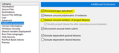

You can try something that i dont recommend for PPL's. But for executables its ok:
CLA / CTD
Message 7 of 13
(4,652 Views)
Thank you for suggestion! With just a bit different setup it worked!
(previously both tickmarks were selected on yellow, see below).
On the downside, is that I still do not really can find why that problem popped out of the blue. And there are no any warning or even hints from the compiler.
Thanks a lot once again for your kind help!
Message 8 of 13
(4,643 Views)
