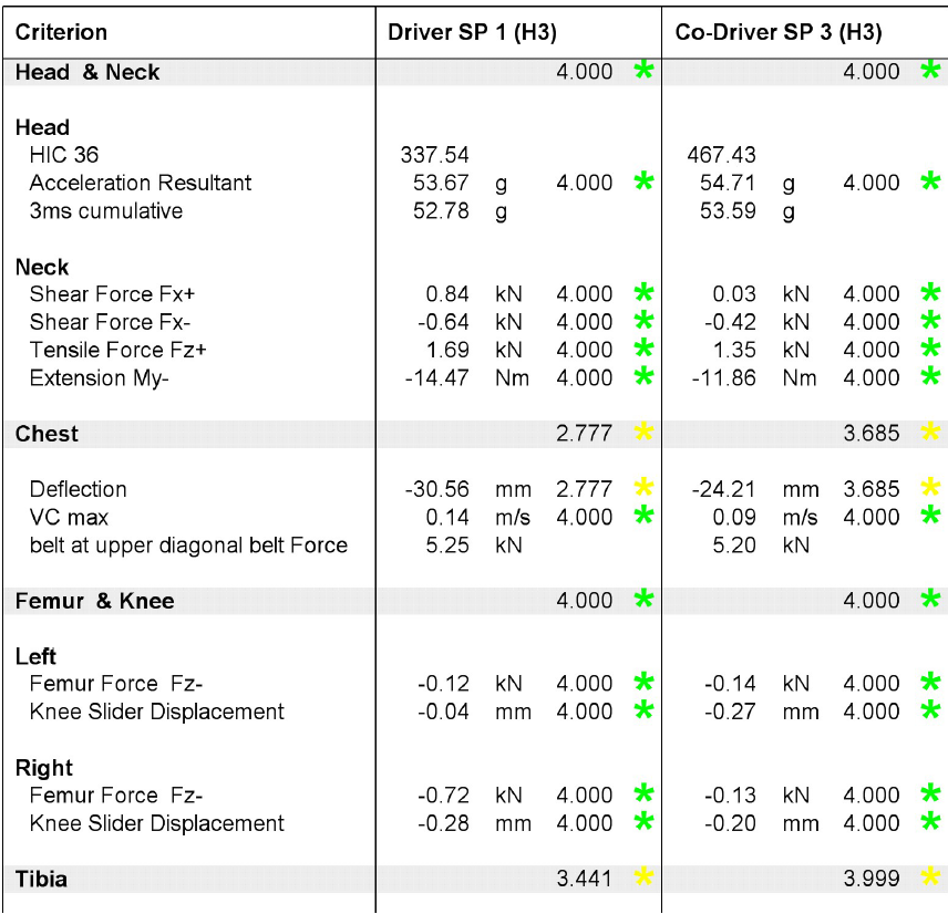

Hello Brad,
 I come to you today hoping you can help me even this time.
 Always the same problem in the table, but this time, I find that difficult if I compare it to the last time.
 This time I try to make a page that summarizes the results of the accident: HIC (36/15), RESULTING Acceeleration, cumulative 3ms, NIC, VC, ThCC .... And which can be used for any case. In a first time , I will interested to the driver (AVG) and passenger (AVD)
 you can find below an example that summarizes what I'm trying to do
I hope that you understand what I want to do.
Thank you
Message 19 of 27
(3,404 Views)
Hi klifoufou,
What we can do in a DIAdem 2011 table is conditionally color the text or change its other text properties such as bold or font.  The method to do this is very flexible, but not obvious at all.  You have to create a VBScript that analyzes the value of a cell and assigns the appropriate coloring, font, etc.  Then you have to make that VBScript a global user command.  Then you have to edit the table configuration to call that VBScript when redrawing the table cells in REPORT.
