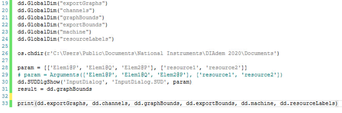

if I understand it correctly, then even when I use python for DIAdem programming, the language for dialogs is still VBS.
My question is, how do I in that case send variables to and from the dialog?
I managed to send variables to the dialog with

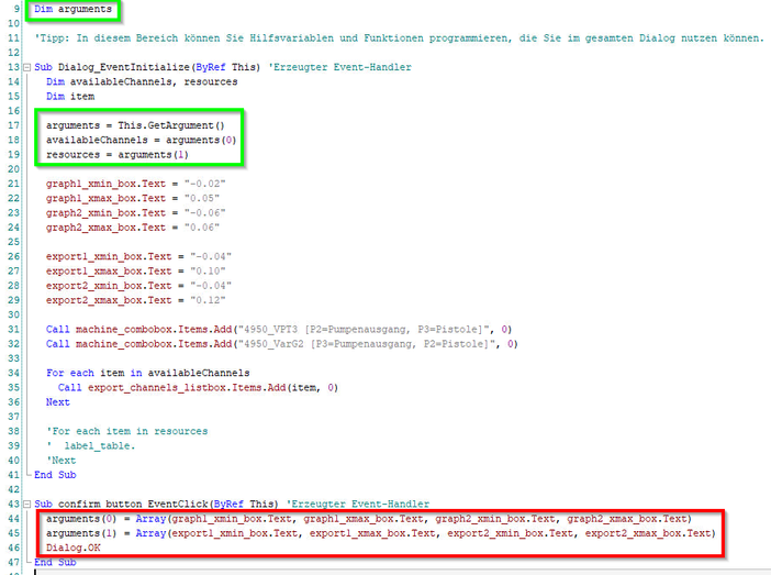

However when trying to modify the parameters (red rectangle on the photo) and read it back in python, the param array is unchanged.
I tried using the SetArgument function, but I was told that this function is deprecated. So then I tried modifying the array directly, but it seems that I modify just a copy of the array, which is not returned to python.

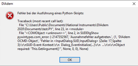

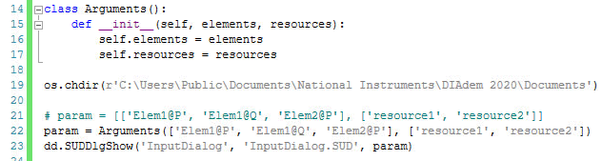

Finally I tried creating a python class and send an instance of the class to the dialog as parameter. However that does not seem to be supported:
