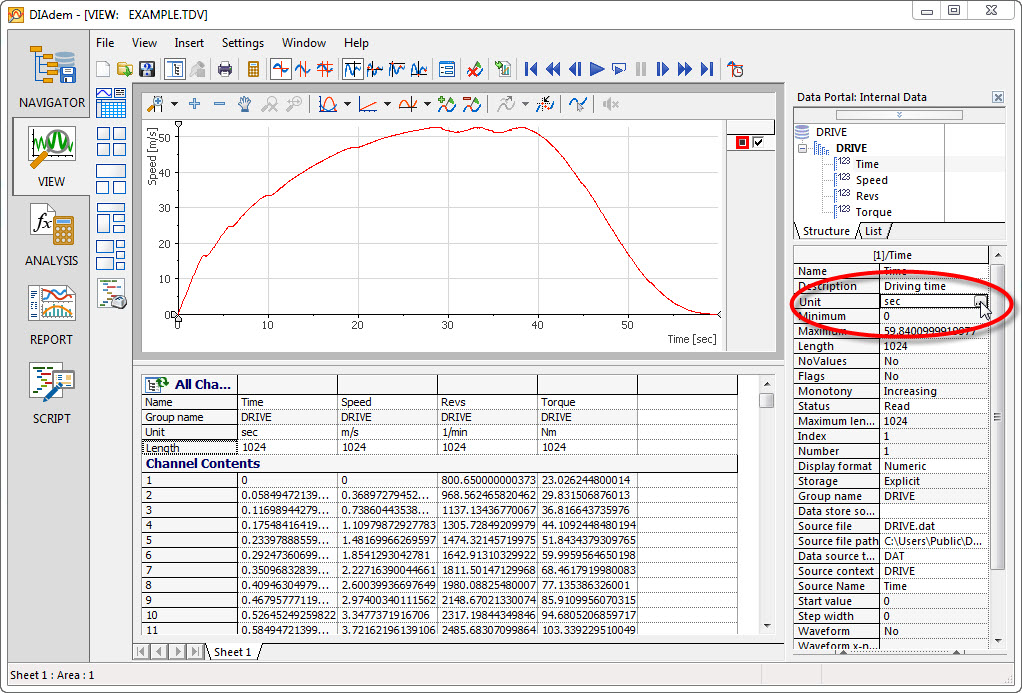

In the Data Portal, select the time channel. Then, in the property view below, click on the unit line. A little icon icon labeled "..." will appear. Click on that icon.

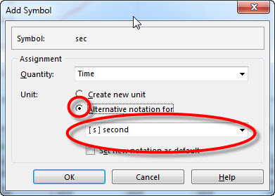

Select "Time" as your measurement quantity (or unit). For the rest of the dialog, set it as shown below:
You have not told DIAdem that "sec" and is an alternative way of writing "s" - which is the SI unit for seconds. You won't have to do that again unless you install DIAdem on a different computer. DIAdem has now learned and will remember.

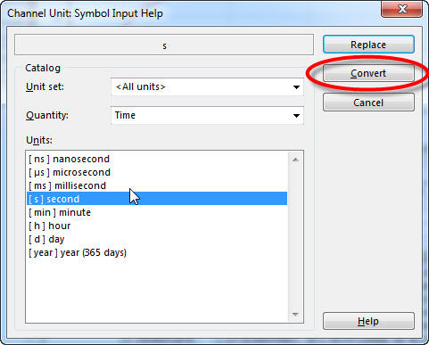

The next step is to click on the "..." button to your unit again, which now brings up the following dialog:
Since DIAdem now knows that "sec" and "s" are the same thing, it will show you the current unit of your data channel, along with all defined alternatives, including "ms" and "min". Simply pick your unit here, and then click "Convert" as shown in the screen shot below. DIAdem will automatically convert the unit of your channel to the new unit you picked. This happens in memory only, DIAdem will not change your file, unless you save the data file in the NAVIGATOR panel.
