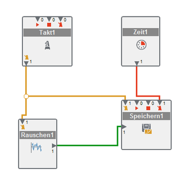

Hello everyone,
I have usecase with a relatively small signal to noise ratio but a "slowly" changing signal. So i can easily use a moving average to filter out the noise.
This setup requires a "high" (100Hz) sampling rate to work reliably. However I don't need that resolution. Saving the Value with a frequency of 1Hz is plenty.
I Know i can resample the signal after it has been saved. However our measurements can run for Days and Saving 100 times the Data is both unnecessary and problematic.
Is there any to save data using a different frequency than the sampling rate?
Thank you for your Input!

Okay, i might be missing something here. But I think this will not work. If i only record one measurement per second, resampling afterwards will not add any Information. However I need all 100 samples to average out the noise.

 In the end the sollution was very easy. Simply run the whole dac on the desired sampling frequency set in the Top left Block("Takt 1" Whatever that is in english. Changing the Language requires a re-intall...). Add a Clock with a periodic signal in the frequency you want to save at in the top right block ("Zeit1")
The Yellow clock will trigger a signal at the sampling frequency. But the Save Block will only save e.g. once a second.
Hope it helps anyone who has the same Issue
