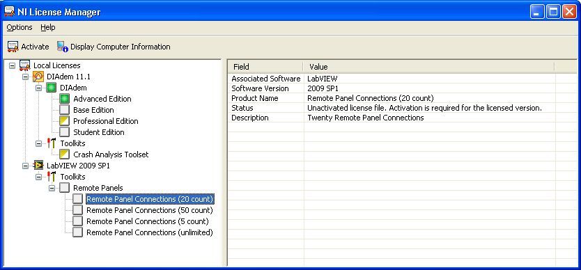

Regarding upgrading to Lookout 6.2 (which I haven't yet done), the Lookout Release Notes recommend uninstalling previous versions first. Do you know how to do this? I tried the NI License Manager, but Lookout doesn't even register (see image below). Is this normal? Neither does Lookout appear in Windows Add/Remove Programs. Yet I know it is on my PC, there is a folder <C:\Program Files\National Instruments\Lookout 6.1> full of .dll and .exe files.
NI License Manager

Hi David,
The Lookout 6.2 CLIENT is for people who don't have Lookout installed but still want to connect to a Citadel database with DIAdem.  That works for both Citadel databases created by Lookout as well as those created by LabVIEW DCS, by the way.
In your case you already have Lookout installed, so you don't need this extra client software.  There were no feature improvements in this interface between 6.1 and 6.2, so you're not missing anything and youre data importing is already working.
I don't know about Lookout not showing up in the license manager, etc.  Sorry.
