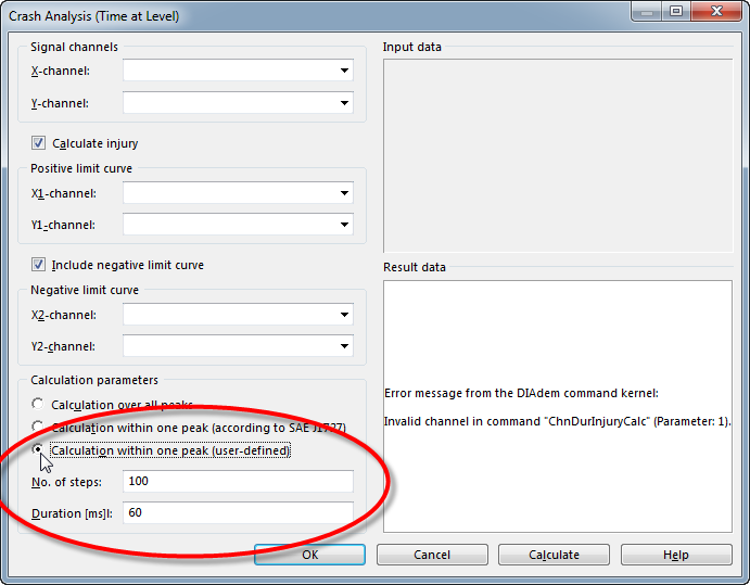

And just for completeness, here is what changed in that particular command from 2011 to 2012:
All E  channels were turned into R channels, only for documentation purposes. E -> R is the translation from German "Ergebnis" to English "Result" - that change has no effect on the function of this command, it's just a spelling correction in the help system.
The two additional parameters: CalcSteps and CalcDuration were added at customer request to allow for additional user defined parameters in this function. These parameters are only required if the radio button (or parameter in the command) is set to "user defined" in the dialog box, else they will be ignored (and greyed out in the dialog).

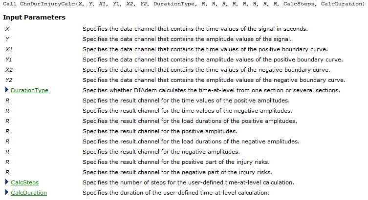

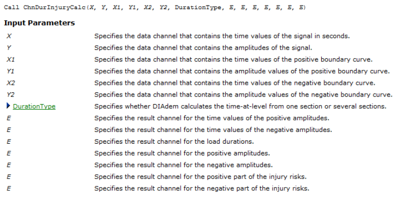

Sorry the syntax I put was taken from internet. Pls refer the below screenshots taken from the software installed in PC.
2011
2011
2012
2012
In 2011 there is only 7 result channel whereas in 2012 version there are 8.

Hello Faz,
I missed the additional result channel that was added in 2012 for this function at customer request, to separate out the positive and negative load durations into separate positive and negative duration channels (that's what I get for answering forum posts at 10:30 pm when my concentration wanes).
Typically, changes are documented in the Release Notes (I don't have access to installed DIAdem 2011 or DIAdem 2012 versions on this PC). We try to limit changes to commands as much as possible to avoid the issue you just ran into, but in this case it was unavoidable in order to add additional functionality.
In my experience Scripts typically transfer without too many issues between different DIAdem versions - unless we make major architectural changes, which are announced ahead of time and usually phased in over multiple DIAdem releases (moving to object-oriented programming on major DIAdem components in the past would be an example).
If you run a 2011 Script in 2012 and it doesn't return errors such as in this case, it will not have any issues and you won't have to hunt down individual commands to check that they work correctly. The Script will either run without changes or throw an error message if additiponal parameters have been added to a command. The error message should point you to the place where corrections are needed.
