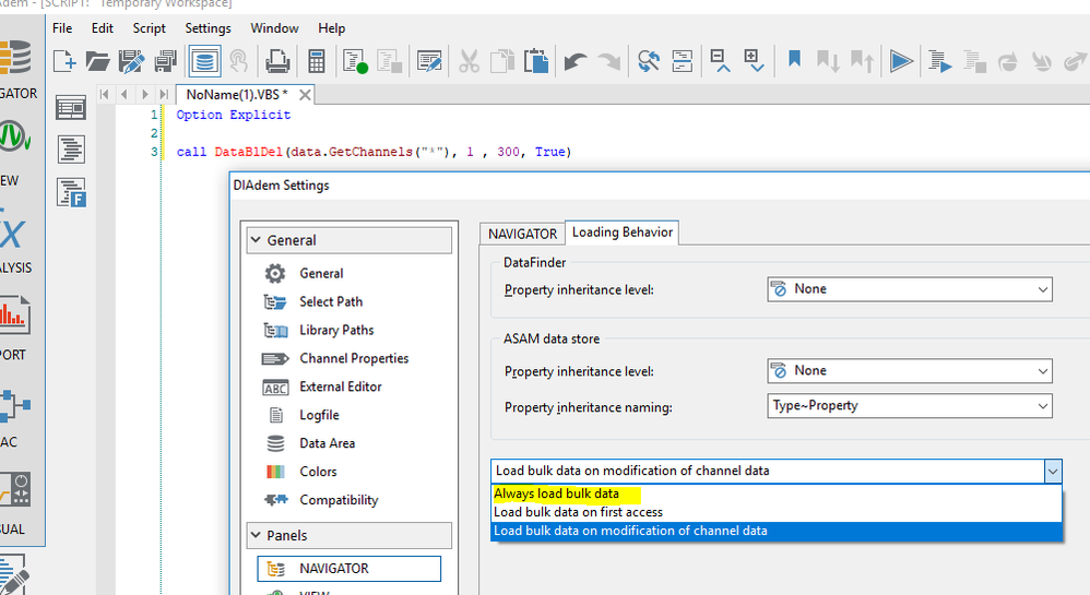

I have noticed that ehe execution of DataBlDel takes a pretty long time when executed via SCRIPT (5.3 s). When I call DataBlDel a second time with the completely same parameters it is much faster and takes less than 0.1 s.
When I start the recorder and crop the channels in the VIEW panel it is also pretty fast, but executing the recorded command in SCRIPT leads to an error message, translated: No valid source or target channels were specified.

Option Explicit
call DataBlDel(data.GetChannels("*"), 1 , 300, True)
use
The speed differences between first and second timecontains the loading time of your file.
This means the data is loaded into DIAdem data portal in the moment that you modify them.
Next time they are already open.
You can change the loading behavior by modify the DIAdem settings.
