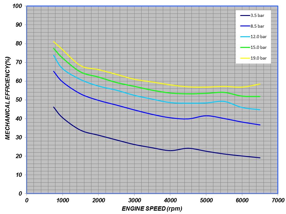

Thanks for the assistance, what I'm looking to do with those pressure windows is to create an average value for the pressure and the other channels within those windows, and then map the pressure curves against speed for  Flow, Torque, Power and Efficiencies similar to the attached image
Peter
