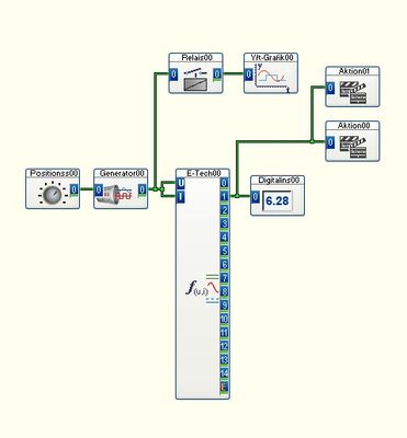

I have another question about triggering.
I want to trigger a signal belonging to the amplitude of a signal. But I am not sure how such a triggering could be implemented.
I tried to use the RMS value. Here is a short example:
This is dificult because I cannot trigger using a desired voltage lvl because of the oscillating waveform. Relais00 should only open when the amplitude is lower than 3V and close if the amplitude is higher than 3V. A combitrigger detects only the value of the actual voltage and not the amplitude.
The solution above is very slow, and i do not use the other values given from E-Tech00. When I change the amplitude from 4V to 2V it takes a long time till the relay reacts. The Diagramm shows the 2V waveform instead of the 4V waveform. Is there a better way to solve this task?
Thanks so much and have a nice day!

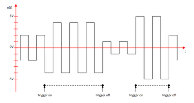

Thank you for your reply. I do not have the worksheet at the moment. But I made a picture of a sample signal where you can see what I want to do.
As you can see I want to trigger the signal. When the amplitude of the signal is higher than 3V the Trigger should start, and when it is lower than 3V it should immediately stop. I could use a normal trigger where the start condition is start when the level is higher than 3.01V for example. But how can I stop the trigger? I cannot use a normal trigger with the stop condition stop when the signal is lower then 3V because the signal is oscillating.
Hope this helps to understand the issue.

Try changing the value for the trigger to an absolute value. Would that work?
Message 4 of 9
(8,654 Views)
I do not know if I understand what you mean. But using the absolute value of the signal does not work because the slopes of the signal are not ideal so that the gradient is not unlimited. Using the absolute value would look like this:
You can see, if I trigger based on a voltage level, for example 3.01V, the trigger would start correctly, but if I have the same stop condition, the trigger would stop as soon as the signal is below 3.01 V what happens after the first half period of the 4V signal. That happens because the voltage falls down to 0V between the three 4V maximums.
Best way in my opinion would be to control the maximum of the last half period. If the maximum of the last half period would be higher than 3V than the trigger should start, otherwise it should stop. Is that possible?
Thanks a lot and Best regards.
Hilby
Message 5 of 9
(8,647 Views)
Hmm, don't know if this works, just an idea:
You can use a Time Delay-module (delay by ~3 values). If you substract the "current value" from the "delayed value", and the result equals 0, the "current value" is on a "plateau", not on a "slope". If this is the case, look at the "current value" again: if it's lower than 3.0, it's time to stop the trigger.
