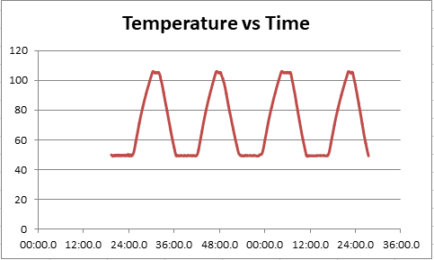

I've been able to tune the PID to achieve the results I desire. I'm trying to automate my machine's ability to turn the heaters on/off and actuate the proportional valve. Right now I'm using TTL modules to control the heating and cooling cycles, but the duration are based off of calculating the cooling/heating rates. I would like to combine TTL with some sort of trigger. For example if the temperature is 49*C turn on the heaters until 105*C. Then hold at 105*C. What is the best way to go about this?
Message 8 of 12
(9,559 Views)
You can set up a Trigger module to evaluate the temperature.... the  Pre-Post Trigger will work to evaluate if your temperature is in or out of range.
You may want to change the number of post triggered values to be 1, not the default 512.
If the conditions are met, the output of the module is 5V, suitable to feed to the Digital Output to control the heater.

That is quite a suitable solution for turning the heat on/off. I would also like to hold the temperatures for certain periods of time. Is there a way to trigger TTL modules based on certain conditions, rather than time? Essentially I want to follow this heating profile.
