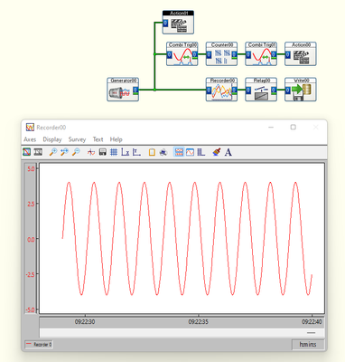

Hi Corey,
There are a few ways to approach to this. Myself, I like to use the Combi Trigger module to generate a pulse based on some criteria. You designate how the trigger signal should go up (start) and how it comes back down (stop). If you set stop to Never, the trigger never resets. But if you set it to Direct, you can designate a time or number of samples it stays high. A simple example of this is to connect the trigger output to a Relay module. Set the trigger start to go up when the data value exceeds 0.0 volts and stay up for 5 seconds. The trigger signal will allow the relay to stay open for 5 seconds letting data flow elsewhere - like a Write Data module.
In the attached DASYLab 2020 example, I use the Combi Trigger twice, once to begin data flow when the sine wave exceeds 0.0v and the other to detect 5 sine wave cycles. Action module reads a Counter that is connected to the Combi Trigger. When it detects 5 cycles it opens the relay blocking the flow of data.  You need to DASYLab FULL or Pro to use the Action module. Take a look at the example and if you have questions let me know.
I hope this helps...
John@MCC

If you really want to use the Action module, you need to change the event.
Input=Value could easily be missed if the time value is not exactly your computed value.
You need the Exceeds Threshold value. If you need to stop exactly, then adjust your computed time by enough to make it stop on the next tick.
For example, if you need to stop at 11.1, then set the threshold for 11.0 or 11.09, depending on your sample rate and the actual values of the time that you're reacting to. You can see this visually by dropping a List module and connecting it to the wire going into the action to see what the actual values are.
I like John's suggestion of using a trigger... that is more synchronous than the Action module... have the Trigger go high on your threshold (again, exceeds threshold is a better choice), and connect to the STOP module looking for the rising edge.
Note that the Stop module is one of the original functions, and for some reason, it was never fitted up with the global variable function. That's why the Trigger module plus the Stop module will work in your scenario.

Hi Corey,
It's unclear to me how the stop would work, but you can simulate the stop control using the Action module. Set the Receiver=DASYLab; Action=Measurement Stop; Event= Input=Value(+/- 0.001%) For value you can enter a number or use a global var. For the input connect, connect it to your signal or to a Global Var Read module.

Here's a way to count cycles. See the attached worksheet.
