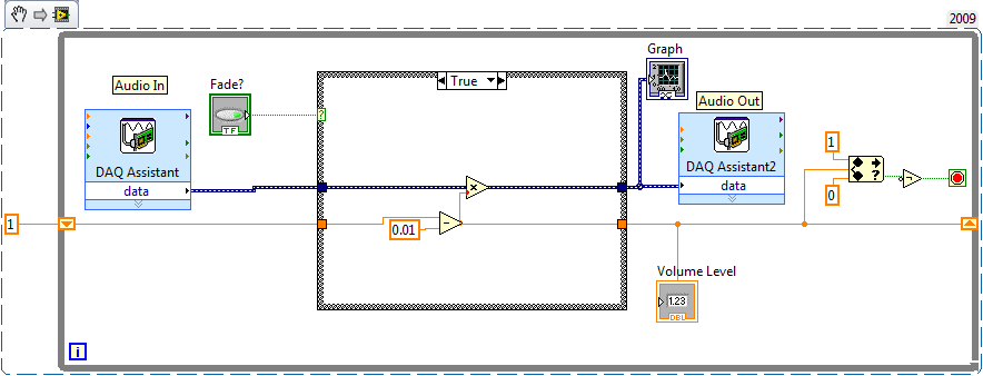

In this video we create a basic fader. When a user flips a switch the volume level fades to 0 and stops the program.
Note that it is highly recommended that you try the exercise problem on your own before watching the solution video. For more information on the key concepts learned in this video look at the links under Additional Resources.

Procedure: Create the required VI(s) to achieve the following tasks.
Requirements:
  1. Create a VI which reads the signal from the MyDAQ audio in port and outputs it to the audio out port.
  2. When a user flips the switch the volume level should slowly fade to 0.
  3. Stop the VI when the volume has reached zero.
  4. DIsplay the audio signal being generated on a graph and the volume level on a numeric indicator.

Example Snippet
