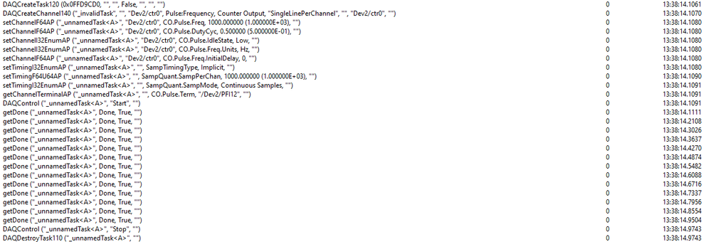

Heya,
I just want to check two things:
1) When we're using the default PFI lines for ctr0/ctr1, are we changing the Pulse Terminal at all?
2) Are you able to pull up NI IO Trace, track NI-DAQmx calls and start the Counter pulse generation?
We should see the Trace call out the creation of the task, channel and the other API calls before closing. I don't have a real PCI-DAQ with me at the moment but my simulated device calls these:
Finally, there's a quick example code in Python at the bottom of this KB - can we try this out?
