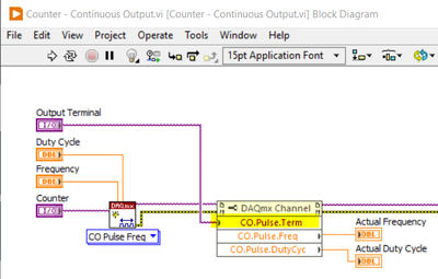

Dear NI community
I use a NI PCIe-6321 with a NI BNC-2110 with Labview on Windows 11.
I want to use the four counter ouputs of the 6321 to produce trains of pulses.
My problem is that the fourth counter output is on PFI15, and the BNC-2110 don't have a PFI15.
Does anyone knows how I can have access to PFI15 with the BNC-2110 ?
Thank you in advance.

PFI lines are multipurpose programmable function input/outputs. You can specify any PFI as the output terminal for your counter.
