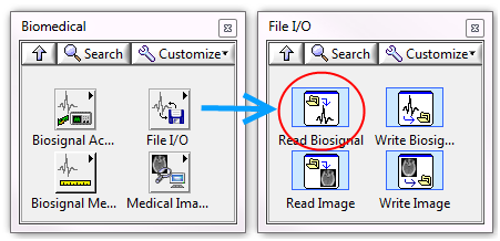

After you install the Biomedical Toolkit, you will find Read Biosignal Express VI under Biomedical->File IO.

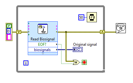

After configuration has completed, click OK to close the dialog. Create an indicator at biosignals and add a while loop outside the Express VI.
Run this VI, you can see the biosignal being imported block by block.

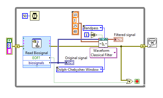

You can do some signal processing when importing biosignals, such as filtering using Biosignal Filtering VI

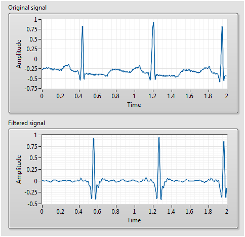

Run this VI, you will see the original and filtered signal in the front panel.
