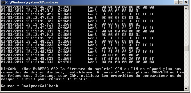

2) The "Can receive with notification " example fails after sometime and displays the following error: ErrorCanReceiveWithNotification.jpg

I eventually found three quarters of the solution. I found that for some unknown reason a collective computing program that usually always gracefully yields enough processor power for other applications to run smoothly, namely the BOINC manager does introduce very long latency times when the NI USB-8473 CAN driver is invoked from an application developed under Visual C++ and using the frame API.
However, the example that uses the callback notification mechanism still fails and I do not know why.
