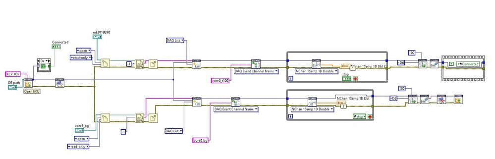

Hi guys,
I am using the measurement and calibration toolkit and I am trying to run multiple measurement tasks in parallel to acquire more than one DAQ List. I am having a problem that whichever MC DAQ Initialize.vi runs first blocks the other from initializing the DAQ List/measurement task and then I get an error saying that access is denied or that there are no free DAQ lists. When I run single tasks I read the signals of each measurement list I have indvidually but I can't do it in parallel. Any ideas on what I could improve or on what is causing the issue?
Here is my approach so far in a simplified version ( I could attach it if needed):
