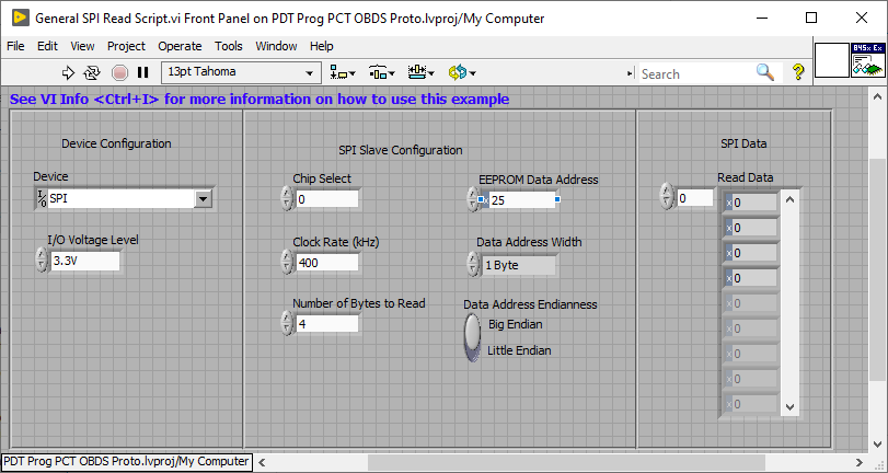

I have to write 4 data bytes on an EEPROM, and read the full EEPROM (512 Bytes) with a NI USB-8452 SPI Interface.
The EEPROM component is a Microchip 25LC040AT-E/OT
I've tested the examples (General SPI Write/Read and General SPI Write/Read Script) but impossible to read something else 0...

I try to understand where is the problem by me...
Power supply (external): 3.3V
I/O Voltage Level: 3.3V
Chip Select: 0
Clock Rate: 40kHz
Clock Polarity: 0 (Idel Low)
Clock Phase: 0(First Edge)
Number of Bits Per Sample: 8
Data Address Width: 1 Byte
Data Address Endianness: Big Endian (MSB 1st)
Page Size: 16 Bytes
I've connected CS, MISO, MOSI and CLK, plus GND of SPI Interface on the GND of my PCB.
First, I've tried to read 4 Bytes, starting adress 0x25. Its what I've measured with scope meter. I normally should read something different from 4 Byes of 0x00...
I work with LabVIEW 2018 SP1 and NI-845x 19.0 and a W10 Computer (64 bits).
What do you think I've made wrong??
Thank you per advance!

Hello Francis,
First of all, sorry for the late answer.
Have you resolved this issue ?
If not, have you put pull-down resistor ?
Eloise
NI France
(2,742 Views)
Hello @Eloise,
Yes it is solved, it was effectively linked to pull-down resistor; vi was OK.
Francis M
