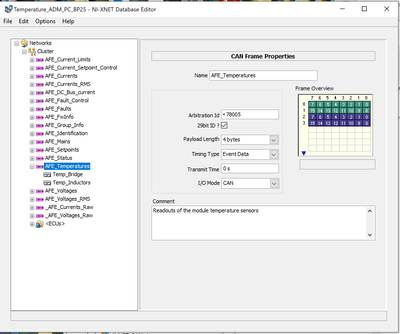

 When I feed these Clusters into the MUX Frame Signal Conversion Example.vi Version 8, I do not see any conversions happening. I have modified the sample VI so that it will process the live CAN frames. There is one frame that I thought should process easily. It is AFE_Temperatures, ID 78005x that has two signals, Temp_Bridge and Temp_Inductors, 16 bits each.
Here is the frame in the New NI DB Editor:
 My VI's and the database file are attached. There are some VI's made for the Peak adapter that will be missing so here is also a screen capture of the RCV & Decode CAN.vi.

I'm not sure why it isn't working for you, but your DBC is able to do the conversion just fine.  I took the Version 8 example code posted, then told it to use your DBC, and set the signals to Receive at the Tester, as Temp_Bridge, and Temp_Inductors.  I then had to update the second constant to have the same value for what signals to write.  Then I ran the VI and it first did the signal conversion to frame, then converted the frame back just fine.
