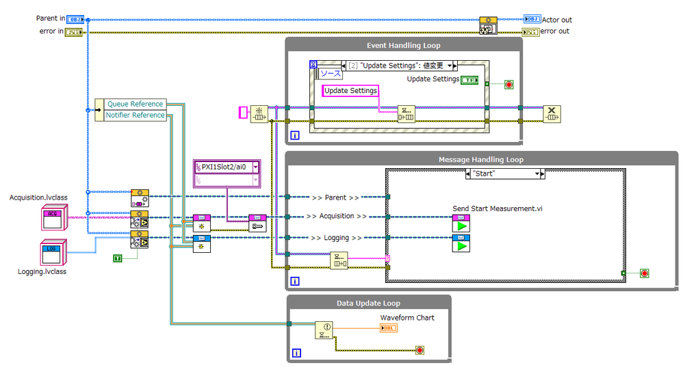

Dear All, I finally decided to use QMH in parallel.
<<Parent.vi>>
Parent.vi just calls "Send" VIs. It doesn't care state of each module.
<<Acquire Actor>>
This actor has QMH loop. This actor cares own state and does each operation.
<<Start Measurement.vi>>
"Send Start Measurement.vi" calls this VI. This VI just sends message to QMH located at Acquire Actor.
One disatisfaction is "duplicated class data". Both "Parent.vi" and "Acquire Actor" have Acquisition class.
Anyway, thanks to your kind advice, I could develop my startup AF Application. Thank you very much : D

This seems like an insanely over complicated and convoluted solution to a pretty simple problem.
What was wrong with the time delayed send message and holding state information in the actor's class data?

Time delayed send message can only be used for slow, non-deterministic acquisitions. If you need high data rates, you need to let the DAQ take care of its own timing.
What the OP is doing is holding state information inside the actor- the complexity you see is a direct result of handing state transmissions, idle states, error states, initialization states, and so on inside the actor. I can't speak for him, but removing states from my DAQ actors saved a massive, massive amount of headache and overhead- if I need to stop acquiring, I stop the actor. Initialization happens inside Pre-launch Init, so if initialization of the DAQ device fails, the caller knows instantly and can make a decision from there. If the actor is already running and the initialization fails, you need to make a new message for the caller notifying it of what happened. Then you have your actor in an Error state, which needs more messages to handle "Acknowledge error and restart" or "Ignore error, shut down" or whatever else you need to handle.
Removing states means you can handle initialization errors at initialization time directly within your caller (since they happen in Pre-Launch Init). Errors during measurements can either be handled internally to the measurement actor and fixed, or if they're critical, they can just stop the actor and notify the caller that it failed and is now shutting down. Errors during Stop Acquiring are usually ignorable- I don't think I've ever cared about an error when Stopping a DAQ task. I'm not saying they're always ignorable, just that you can throw away 99.9% of them since you're shutting down the acquisition anyway. Non-ignorable errors can, of course, send a message.
In short: holding state information in the actor's private data is basically what the OP did, but it's in an internal QMH instead of the main actor's private data. The complexity comes from handling all of the state transitions. Generally, I don't want my caller to be the one deciding how to handle errors that happen *inside* my acquisition loop anyway- the caller should just know "Is acquisition doing its thing OK or not?"

I don't see anything indicating that high data rates are required - given that in many of the images the waits are above 100ms, there is no problem using the time delayed send message. Your method of just starting and stopping the acquisition actor is another perfectly good solution to the problem.
The implementation pictured above is not a good solution to the problem. Its an overly complicated and convoluted way of doing things. There is no reason not to just put all that functionality into methods that are called by messages.
The complexity comes from adding one form of message handling loop to another form of message handling loop, and having the first message handling loop reformat and forward messages to the second message handling loop, when the first message handling loop is perfectly capable of handling them.
Hey, why not add another loop? Maybe use an event structure, and have the QMH loop generate events and that is where the acquisition occurs? Its added complexity that is totally unnecessary.
There are times when a parallel message handling loop is needed by an actor. This isnt one of them.

Agreed 100%. I'll retract my previous statement about where the complexity comes from; if you have an acquisition helper loop with its own timing source (i.e., the DAQ's onboard timing), then you can wind up having lots of required complexity from handling messages between that loop and the actor core. I should say, PART of his complexity is coming from maintaining state across multiple loops.
