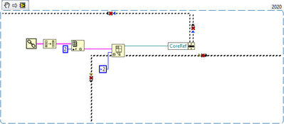

I have the problem that the ActorCore references of BaseView overwrite the references of its child actor TestpanelView:
- In ActorCore.vi of the BaseView class I save e.g. the VI server reference or string refence into private class data (see attachment)
- In ActorCore.vi of the TestpanelView class I want to save the same (see again attachment), but when launching the actor, the BaseView class ActorCore.vi will be started which then overwrites the references saved from TestpanelView class
It seems to me that there is no fine way around calling the direct parent Actor core.vi...
Is there any way to get around this problem? What does best practice suggest in this case?

Hi Jenso,
If i understand well your problem, there is a way to solve it.
Use the snippet attached to create a sub VI for your BaseView actor to assign a private data for the reference.
Then call it just before the parent actor core of the BaseView 's actor core.
The ref will always be valid for any child of this class, whatever the child depth it has. Use a read only property in your child class to access it.

In the data accessor VI, you could check to see if the property already contains a valid reference. If so, skip setting the value. This would mean that the property will keep the value from the first VI to write to it. If you always write that property in your Actor Core overrides, then the first class to write to it should be the class at the bottom of your inheritance chain since the write will take place before the call parent VI. (This sounds like your desired behavior).
This method breaks down if you need to write to that property from different places in different child classes (it becomes much harder to guarantee the write order) or if you ever need to overwrite that value during the lifecycle of your actor.
I use a similar strategy in some of my applications, so I'm interested to hear any better ideas too.
