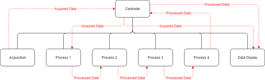

I think what I might do is restructure the hierarchy a bit. I would have a supervising actor (controller?) That knows about the acquisition and processing that needs to be done.
The controller would launch an acquisition actor, who would send it's data to the controller. The controller would also launch the data display and all the process actors.
You could configure the process actors with a Q to send it's data, instead of the controller needing to receive and pass the processed data to the next process step. So the controller would give process 1 the queue for process 2, process 2 the Q for process 3, etc. For the last process step you can give it the controller Q. This way you could add a process step in the future without needing to change any of the other process actors. You would just have the controller launch it and adjust the Q's to add it to the pipeline.
In the end, the controller will receive the acquired data and can pass it to the data display as well as the first process step. It can also send the finished processed data to the data display.

Tried to create a quick diagram to explain a bit more:

Thanks a lot. That is the one I think about at first. I did not get how to pass data from process 1 to 2, 2 to 3 etc. you mean controller give a Q to them. Is that a same enqueuer? If so, it is not a pipeline process anymore. Could you give me more detail about Q?

You would have an actor queue (call it the Send Queue) in the private data of each processing actor with an accessor to set this queue. If you have four processing actors the controller actor would:
  1. Use accessor to set process 4 actor's Send Queue to the controller queue (want's to receive the finished data itself)
  2. Launch process actor 4
  3. Use accessor to set process 3 actor's Send Queue to process 4 actor's queue (received when launching actor 4)
  4. Launch process actor 3
  5. Use accessor to set process 2 actor's Send Queue to process 3 actor's queue (received when launching actor 3)
  6. Launch process actor 2
  7. Use accessor to set process 1 actor's Send Queue to process 2 actor's queue (received when launching actor 2)
  8. Launch process actor 1
Each process actor doesn't know where the Send Queue goes, just that it needs to send the data on this queue. To kick off the process pipeline, the controller would send the acquired data to process 1. The process chain will run and you'll receive final data from process 4.

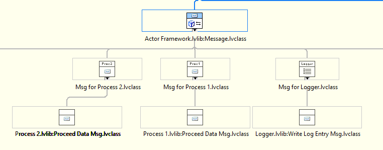

This hierarchy seems to me also more natural. But, You do not necessarily have to break the AF standard communications path. You can override Controller's Receive Message.vi in the following way:Receive Message.png
Root equals Controller in my case.
For process N you need to define an intermediate class. e.g. Msg for Process1.lvclass inheriging from Message.lvclass. If you now create a message for Process 1, you only need to change the parent class from Message.lvclass to Msg for Process1. The class hierarchy of the messages looks like this:
At last step You need to create a map between you process and message base class, when You launch the nested actors:Roots actor core.png
Now You can just send desired message from one nested actor to another one via the root (contoller):Send Messages.png
The rest is done by the contoller::receive message.vi.
