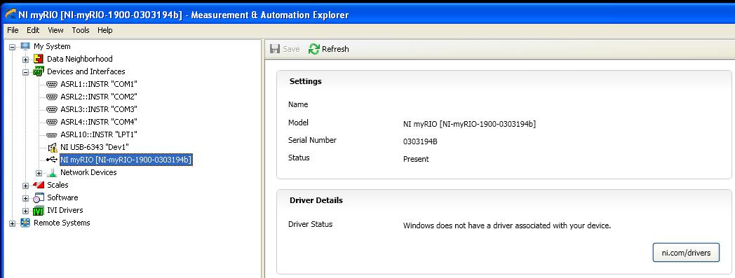

The unit is powered and connected to the USB port on my computer, because the myRIO Unit does show up under MAX - But indicates that Windows does not have a driver associated with it...
I went to the ni.com/drivers site and installed the drivers - Made no difference...
Any suggestions from users on how to fix this? Feels like I'm making a "newbie" type of mistake but can't seem to resolve it...

See this article -
http://www.ni.com/white-paper/14650/en/#406307_by_Date
Install Windows XP driver manually....

Hey Hunado,
That is exactly how the myRIO should show up.  It acts as a Virtual Network adapter to establish a connection to your development computer.   (Let me know if you have questions about this. )
Are you able to see the myRIO in MAX under Remote Devices?  Do you have a firewall enabled?

Hi Sam K,
Turning off the firewall indeed does the trick!
Thank you very much for your help 😉
