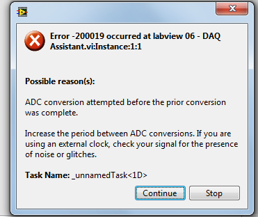

sorry i could only test and get back to you at this time. I tried the DAQ Assistant, and it worked for one signal but i could not get it to work when i assigned it to read 2 analog inputs.
It just showed the error below.

The DAQ Assistant using Analog Input channels should work just fine for more than 2 channels.  When I created my example, I used 4 channels.  What are your sample rate and number of samples settings? It's possible that the Assistant is configured to read faster than the device is capable. ELVIS devices are not simultaneously sampling, which means that the hardware's specified maximum sample rate must be divided by the number of channels used. The more channels you have, the slower each channel can sample.
For more information, see this document.

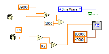

Hi, i also want to to ask about this function gen. Because i want to put a range to the waveform, i was wondering what values i should put for the sampling info, top and bottom value. The values i currently used creates a waveform random but it has something like the image below and then another waveform of different frequency.
Which is actually what i want but, i want it to look more like the image below.
 So for eg. it has a sine wave of 100Hz for a period, then for the next period it is a wave of lets say 1800Hz and so on...
