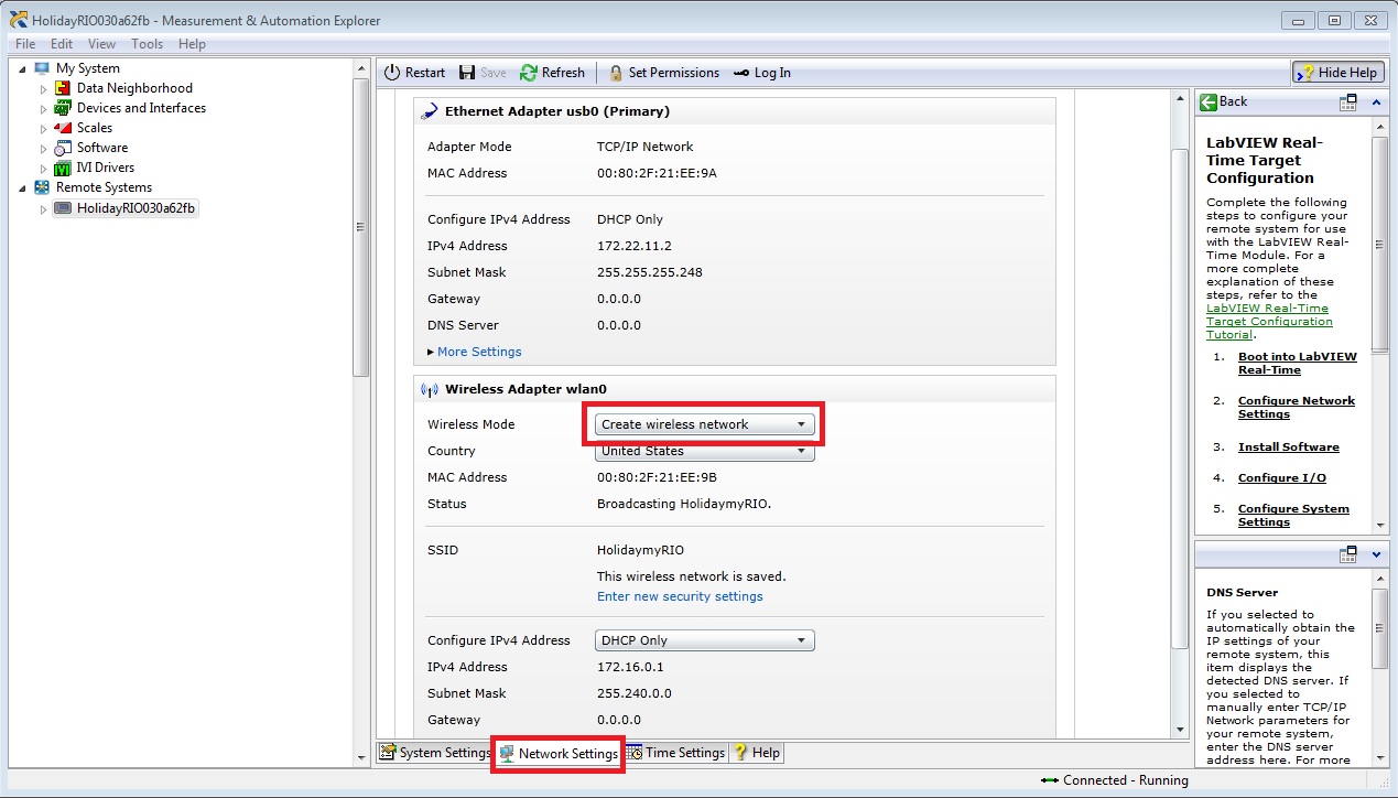

Here is where the option to create a wireless network shows up in MAX. Do you have the Wireless Adapter wlan0 box under the Network Settings tab? I have outlined where these options in the attached screenshot.

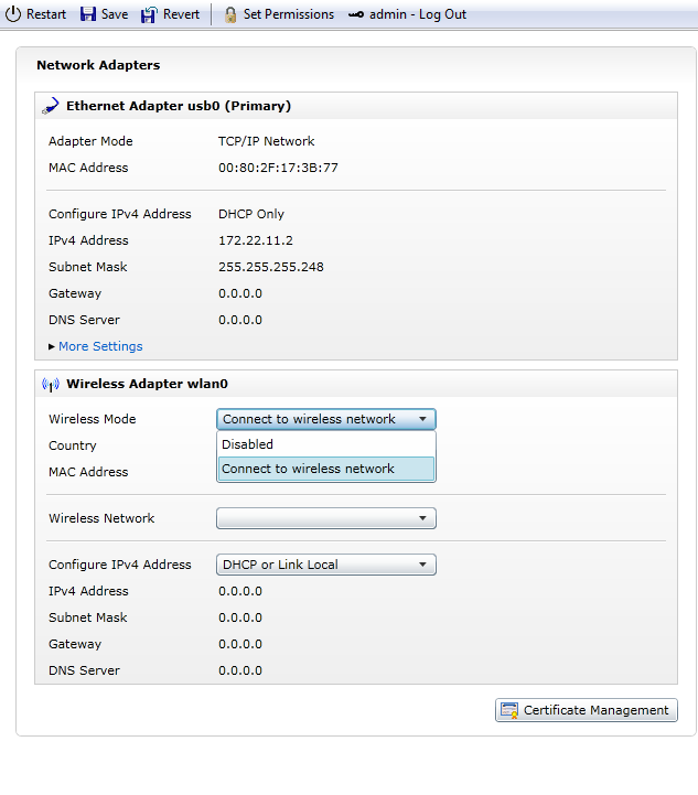

Installed the toolkit. Still getting this

Thanks HizNI!
The toolkit updated the firmware on myRIO and I finally got the option to create a wireless network.

Hi, after I update the firmware to 3.0.0f0 with the UNI Lab computer, there is no option for "Create wireless network" but  only got "connect to  wireless network". I do believe the pc got all the necessary toolkit and driver, and before update it works fine with the previouse version. Please advice if there is any possible solution. Thanks.
