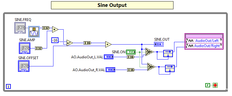

What is the best way to generate a 1khz sine signal on one of the analog outputs of the myRio device? I tried a timed loop and the Point by Point Sine Generation VI similar to the Electret Microphone demo or this post: http://forums.ni.com/t5/Academic-Hardware-Products-ELVIS/frequency-matching-problem-with-myrio/m-p/2... by Sammy_K. But the resolution is a problem. The frequency is not very accurate and with a dt of 100 uS and a 1Mhz Clock I only get 10 samples per period. A dt of 10 is too much load for the processor (the deivce does not respond anymore and needs to be restarted). Is there a better way of generating a 1khz sine output or do I need to do this within the FPGA somehow?

The best and most performing way to generate a sine wave with the myRIO is to do it with FPGA. The onboard FPGA works completely in parallel and wouldn’t need some CPU resources.
The 2 following links should help you to generate a sine wave on the analog output from myRIO.
SineWave Generation using LabVIEW FPGA
https://forums.ni.com/t5/Example-Code/SineWave-Generation-using-LabVIEW-FPGA/ta-p/3996177
myRIO FPGA Sine Wave Sound Output
https://forums.ni.com/t5/Example-Code/myRIO-FPGA-Sine-Wave-Sound-Output/ta-p/3505365
If you still have troubles to generate the sine wave, you can send us your VI so that we can help you further.

Hello Marc67, hello Sammy_K,
As I said before the timed loop is not fast enough to generate a clean 1khz sine signal, so I implemented this functionality with the FPGA and attached my solution. I didn't choose fixed point arithmetic for a reason. Using only integer values (apart form the frequency) I won't loose any accuracy. The frequency and amplitude don't have to change very fast (or at all after initialization) so I can calculate these within my RT Vi.

Hi Marc67,
I tried to make some change on the first example to make it fit myrio. But I really do not konw how to do it. It seems like some functions in PXI are using different data type from myrio functions. So just by changing the functions it still not work. And some of the funcions like SinescaleProp.vi can not be found.
Could you show me a little bit how to make it fit in myrio in detail?
BTW, In the second example why the Audio output is used? I tried to change that to Ao but it did not work. I can not get a Sine Wave from Ao. Could you tell me the reason?
