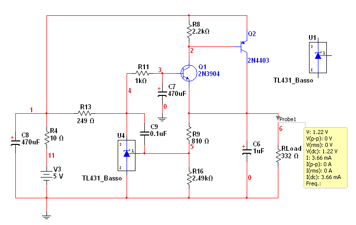

I've copied Christophe Basso's TL431 model into Multisim.  The model works well, reflecting gain/phase as seen in Christophe's book "Switch Mode Power Supplies"  However, when there is another instance of the component in the same schematic, unexpected results occur. When the simulation first is run, the output voltage is correct @3.3V.  If I place another TL431 I get what is illustrated in the snapshot.33_B.gif
Nodes 1=REF, 2=Anode, 3=Cathode.  The model:

Hi Jackinnj,
By placing a component on the work area, even though it's not connected to the circuit it will be part of the netlist and can affect the simulation.  It can alter how the SPICE calculates the circuit and there may be common ground inside the model which means  unconnected component is not part of the circuit.
Tien P.
