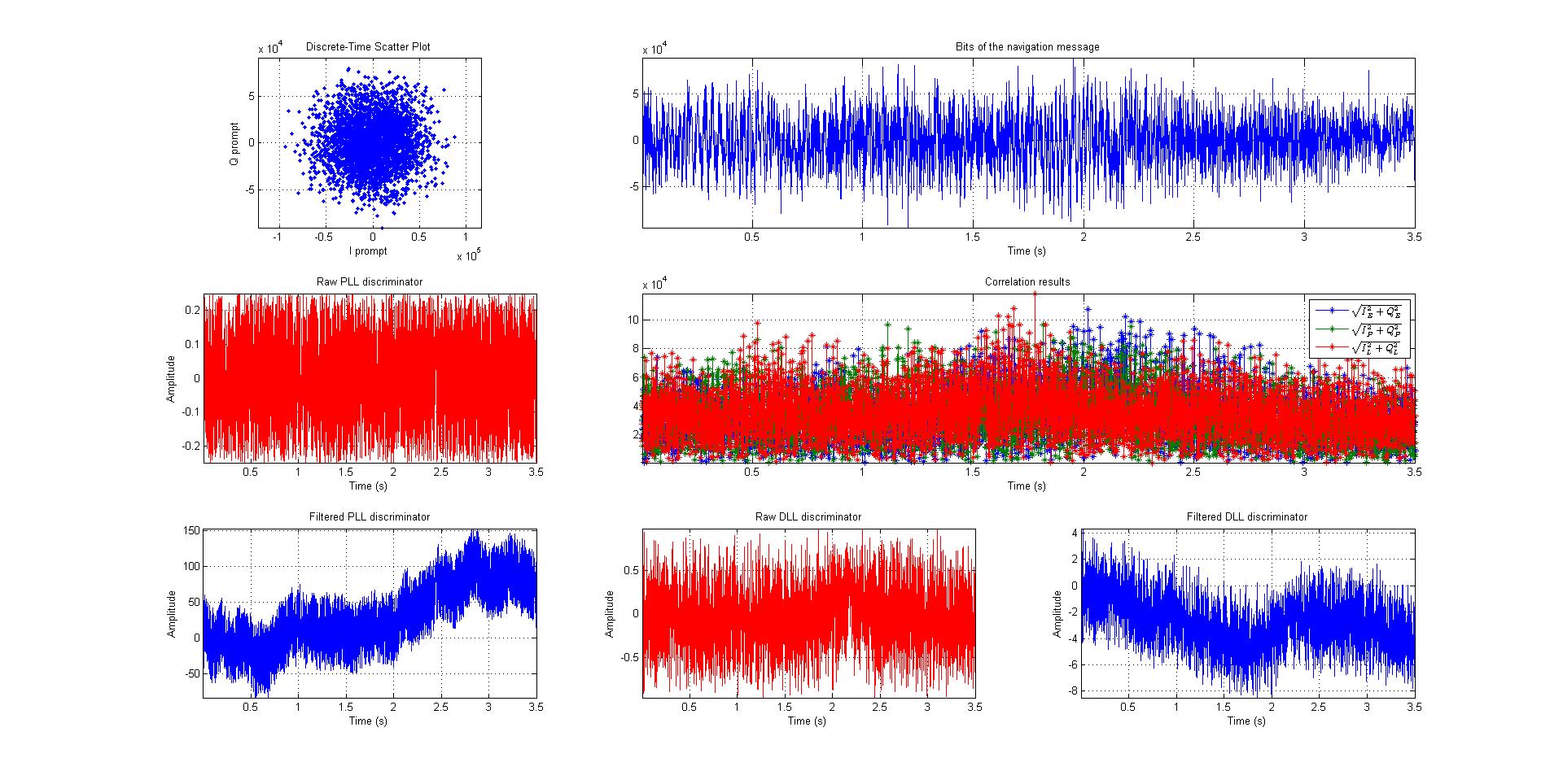

I have been trying to solve this issue for a long while now. First some key aspects about my testbed/experiment that I would like to mention:
1. I'm sure people are aware of the big GPS SDR project from Dr. Dennis M. Akos [1], which is an SDR GPS baseband receiver based in MATLAB. (Website: https://ccar.colorado.edu/gnss/). It is the platform I am testing with pre-recorded GPS signals.
2. I have been trying to capture GPS signals with an NI-USRP 2932 and save them in a binary format with int16 data type and I-Q interleaved samples: I0 Q0 I1 Q2 I2 Q2 ....etc
3. I would also like to mention I am using the NI GPS Simulation toolkit for transmitting GPS signals. This GPS Toolkit works fine because I have tested it with a Commercial GPS Receiver (i.e. Garmin, etc). I'm specifically using the NI GPS Direct Streaming Generation.vi
4. Most of my attempts of collecting data is by directly connecting the transmitter (NI PXIe-1075 with a I/Q Generator, RF Generator, Vector Generator, MXI Express connected to a PC with LabVIEW and NI GPS Toolkit), to the receiver (NI-USRP 2932) via an SMA cable. I've tried with and without attenuators.
5. For capturing data I've tried INT16, INT8 mostly, by using the Property Nodes at the receiver such as Host Data Type, Sample Width, Expected Peak, etc.
So I was wondering if anyone has had issues with this or is something missing. I am aware the NI-USRP 2932 has an OCXO clock, which even without the GPSDO, should perform well enough for post-processing baseband GPS signals.  By the way, just as a note, this MATLAB SDR is able to track signals when recorded with the SiGe GN3S Front-End which has a 1.5 ppm TCXO clock, but not with the NI-USRP 2932 which has a 2.5 ppb OCXO clock. My main issue here is Tracking. Acquisition works just fine, finding the satellites that are being simulated in the NI GPS Direct Streaming Generation.vi.
Here is a picture of the spectrum I'm getting, which in my opinion looks pretty clean:
Now, whenver I run the tracking loops with the MATLAB-SDR, the tracking loops look very noisy. (Again, Acquisition does work fine.)
I'm unsure what is the issue and was wondering if anyone had worked with this MATLAB receiver and if anyone has been successful at processings GPS signals with NI-USRP 2932.

So, when I record with this VI, by using chunks of data of 100ms, I get the following in MATLAB with the GPS SDR I mentioned before:
You can clearly see the DLL loop having a big shift every 100ms, thus concluding that the signal could be "slightly" delayed every 100ms. Also, if I choose something like 1ms, ithe tracking loop doesn't even work. It gives me the results I showed in my first message. It seems the delay every 1ms can't be handled by the DLL.
So my question here is, how can I record continuous data from LabVIEW and NI-USRPs? I need something like 60seconds or so for GPS navigation testing.
