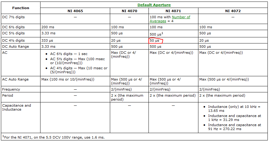

You are going to want to start off by determining the aperture time for your 4071. You can find the default aperture times by looking at the DMM Help (NI Digital Multimeters Help >> Devices >> NI 4071 >> DMM Measurements >> DMM Measurement Cycle >> Aperture Time).
We can see that for 4 1/2 digits on the NI 4071 the aperture time is 50us.
