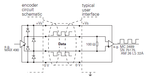

I am trying to use a 10-bit Absolute encoder with an SSI interface hooked up to a USB-6008 DAQ card reading into labview. The encoder we are using is a Baumer BMSK 42L1G05C10/0006B http://uk.rs-online.com/web/search/searchBrowseAction.html?method=getProduct&R=4361214 and datasheet here; http://docs-europe.electrocomponents.com/webdocs/0144/0900766b80144560.pdf
My original intention was to use one digital I/O line on the USB-DAQ for the clock out and one for the data signal in - however I have been informed from a controls specialist that the TTL I/O lines on the USB-6008 will not be able to drive an SSI interface and we will need a differential line driver/reciever (e.g. http://uk.rs-online.com/web/search/searchBrowseAction.html?method=searchProducts&searchTerm=460-679) sitting between the DAQ card and the encoder. Can anyone comment on the ability of the USB-6008 to drive an SSI interface?

The data sheet does suggest using a differential line driver and even gives a few specific part suggestions:
The benefit of utilizing the differential driver is an improved tolerance to noise.  It might not be necessary for you if you just connect the Data+ line to your DAQ card and leave the Data- line unwired, but I can't say for sure without trying it out.
