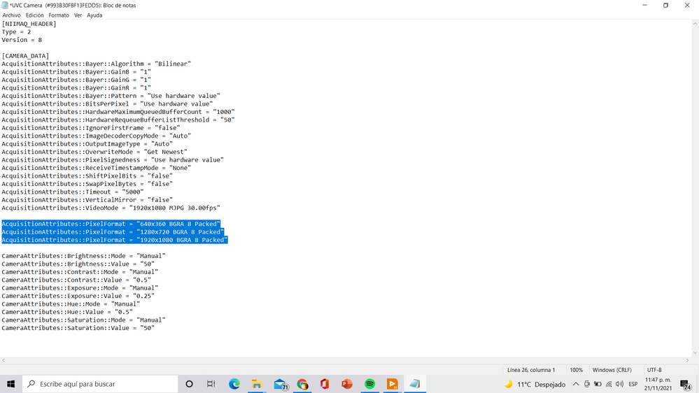

I´ve commented the errors that i got, but i´m not pretty sure if it was the correct procedure because im still not able to run my webcam because the same message keeps saying the same warning. I hope that there is something that could be done..I would really appreciate if  anyone know something about itPossible xml file.pngCommented errors.pngError report.png

Don't piggy back on old messages.  The one you posted on has been solved for several years, so it is less likely to be looked at.  It also has nothing to do with your issue.  You should start a new message.
That said, it looks like your camera has an error the first time it tries to take an image after changing the mode, but works after that.  Try turning on "ignore first image" and everything should be fine.
Bruce
Bruce Ammons
Ammons Engineering
Message 18 of 18
