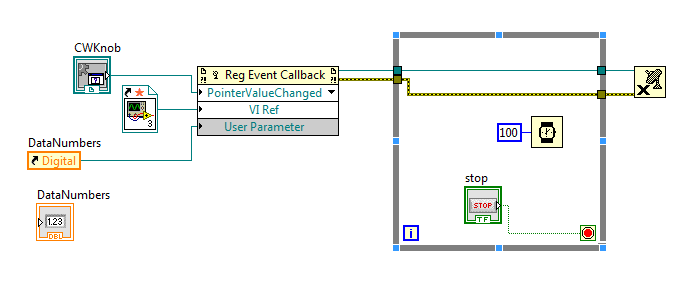

I am building a control for a Laser machine which base its controls in ActiveX control technology. I had a program in C# that works, but I because I wanted to change parameters and later on connect it to another Labview program, I am "translating it".
I am starting from a very basic operation:
  1. "start" ActiveX server
  2. "load" a design file for the laser.
  3. "end" program
and then based on event (using reg event callback):
if laser signal 'QueryStart' is activated by a switch, then "execute" program.
if laser "starts", then light a led
if laser "ends", then light a led.
I have problems to light a led using the VI ref (LaserStartedLed). I am using as a template the Labview example: CWKnob to visualize a number from the knob. But In that case they use numbers from the knob, in my case is just Boolean, and I am trying to get it from the Event Common Data.

OK, here are a few questions:
- Why do you use variant to data in your LaserStartedLED SubVI? It seems you're just converting I32 to I32.
- Do you know about dataflow? In your Main vi most of the code executes whenever labview deems fit. If that's OK, it's OK.
Regarding your actual problem: What does the callback Event look like? What data can be passed to it? What information does the callback give you when triggered?

Hey,
Seems a bit pointless to convert an I32 to I32.
That VI in general seems a bit off: you check the event source and convert it to a boolean array and then you and over the array. Does event source really return 32 true bits?
The sigLaserStart Event triggers, once the laser is on. Can't you just wire a True constant then, just to try it out? You could also call a one button dialog to see if the event triggers. I think the property node in your subVI has to be wired to the other (nameless) Reference, too.

OK, but if you compare your subVI to the picture you posted you note two things:
1. The property node is wired to the nameless reference.
2. The cluster this is connected to, does no longer exist. Instead you wired it to another cluster.
So I would suggest:
Try wiring a true constant to the property node (that you connect to the correct reference) to see if oyu can access the FP Element. If that works we can start figuring out how to actually get data from the event. (I assume very similar to oyur example, by variant to boolean conversion)
