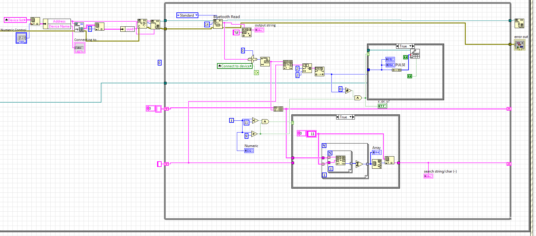

I'm trying to build a VI that recieve the heart rate from the polar wearlink bluetooth device for heart rate acquisition. I have build a vi, but the data from it is just gibberish for me. So I don't know how to transform it to anything useful. I'm using labview 2011. So far this VI looks like:
Data data which comes out from data out looks like:

okey, i found out that the messages from the polar should look like this:
fe 0a f5 07 d1 4b 03 3b 03 22
fe 08 f7 08 d1 4b 03 57
fe 0a f5 09 d1 4a 03 5b 03 53
fe 08 f7 0a d1 49 03 66
fe 0a f5 0b d1 49 03 58 03 4f
fe 08 f7 0c d1 49 03 23
fe 0a f5 0d d1 49 03 20 03 1f
fe 0a f5 0e d1 4a 03 2e 03 04
fe 08 f7 0f d1 4a 03 20 fe 0a
f5 00 d1 4a 03 27 03 1d
fe 0c f3 05 d1 5f 02 48 02 4f 02 48
fe 0c f3 00 d1 64 01 02 01 48 06 34
fe 0c f3 0d d1 62 02 12 02 0b 01 3d
and so on. Where the third hex f3, f5 and f7 decides the message size. And the sixth hex is the heart rate.
The data I get from the bluetooth seems to "miss" some of the data in the transfer?! Because i get the data:
FE08F701F1000317F1000317
FE08F703
FE08F704F1000317F1000317
FE0AF506372
FE08F707F146F508F14603410343F147034D
FE0AF50A2E9
FE0AF50BF14B
FE0AF50CF1490313F70DF1490366
FE0836C
FE0AF50FF147
FE08F700F1470330F147035E036B
FE0832A
FE0AF503F147
I have tried several different read options to the bluetooth read function, but still the same problem. Anyone know how what to try? I add an attachment of a picture of the code and the code itself
Message 5 of 15
(10,297 Views)
Accepted by topic author JonasL
A wild guess is this has something to do with the message size and the fact that you wire a 12 to the " bytes to read" input:

ah okay, now it is working. Added another bluetooth read, and the message size to bytes to read to that one. Thanks! Smiley Happy
