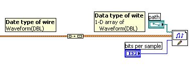

hmm.. it appears that the save to wav file VI's are looking for an array of waveforms.
I am extracting one channel of a four channel analog input (it's reading a microphone). The data was previously saved to a .tdms file.
the tdms file has four channels. If I open it, extract the last array, I can play it into my speakers and it sounds fine.
But when I try to save to a wav file using the VI, it's telling me that I need to send it an array of waveforms, rather than a waveform.
Am I doing this right?
Jeff

Hello Jeff,
From the LabVIEW Help description:
Sound File Write Simple (Windows, Linux)
Writes data from an array of waveforms to a .wav file. This VI automatically opens, writes to, and closes the .wav file. Windows You must have DirectX 8.0 or later to use this VI. Linux You must have the Open Sound System (OSS) driver to use this VI.
So, the data input to Sound File Write Simple.vi is an array of waveforms. However, if you only have one waveform, you can build an array that contains only your single waveform using the Build Array VI. As described in the LabVIEW Help description:
Build Array
Concatenates multiple arrays or appends elements to an n-dimensional array. You also can use the Replace Array Subset function to modify an existing array.
So, for example, you could run your single waveform into the Build Array function and get an array of waveforms containing only your waveform. You could then wire this array of waveforms to the Sound File Write Simple.vi. This is shown in the image below.

wonderful! That worked, thanks!
It's a weird concept to accept though, that I can turn one waveform into an array of waveforms..
anyway, I've solved my problem, so thanks again!

Hello Jeff,
The Sound File Write Simple.vi takes an array of waveforms as an input because it can merge these waveforms into a single sound file. For example, if you wire an array with a 1kHz sine wave and a 10kHz sine wave, the resulting sound file will be composed of two tones. One tone will be at 1kHz and the other at 10kHz. So, by taking an array as an input the Sound File Write Simple.vi allows the user to mix separate waveforms into one sound file. However, since you wanted a .wav file of only your waveform, you only needed a single waveform in the .wav file. However, since Sound File Write Simple.vi requires an array as the input, you have to build your single waveform into an array. This results in an array with one element (your waveform). I hope this clarifies things.
It's like a 1-D array with exactly one element.  But in this case, the element is a waveform.
