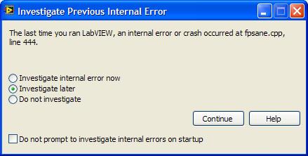

The last time you ran LabVIEW, an internal error or crash occurred at fpsane.cpp, line 444. WHY?
I keep getting this error every time I open LabVIEW 10. Everything seems to be working fine whenever I'm using it but for some reason, LabVIEW would not close properly and linger in the background. I still see the icon in the task bar and I would sometimes close it with task manager in order to re-use LabVIEW. Does anybody out there know how to fix this problem?

Hi macolit,
This is typically associated with a specific VI, as discussed in this KnowledgeBase article. Does this happen every time you use LabVIEW, or only when you've opened and used a particular VI?
Andy H.
(6,445 Views)
Every time I use LabVIEW.
(6,442 Views)
As noted in the KB article and in the log file, the VI you were working with has a problem. Some of the objects on the front panel are corrupted. Your screenshot indicates that you're telling LabVIEW to investigate later, so when you start it up it's doing exactly that, since you told it last time to "investigate later". The fundamental problem is with the "Table_TR6_V1.0" VI.

Even though I put it as investigate now, I would still get the error.
How do I figure out which one is bad in Front Panel?

Thanks Hinz,
I believe I was able to solve this particular problem myself by using "LVdebugKeys". I was able to isolate the offending VI using the debug and it came out that an old "Write Test Data to File vi." does not work well with LV2010. I replaced this vi and it no longer gives me the error.
