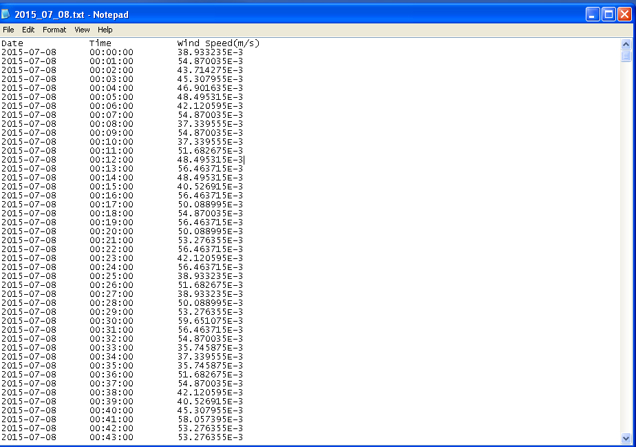

Beside insert the wind speed data collected into text file, i have to insert the data into mysql database too, can i do it with my current vi file ?
DSN server is set and database connection is ok. but it show some error once i start my program, the i attached some pic of my programs, error, and table to insert into mySQL.
Can i have any suggestion on what have to correct in order to get it work ? Really appreciate it !
This is the data log into text file. i wanna do the same to mySQL. logging data to both places.

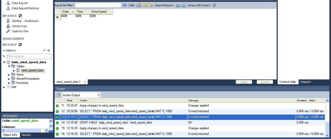

This is where i wanna insert the data into mySQL, 3 columns with header inserted, Date with format "DateTime" Time with format "TimeStamp"  Wind Speed with the format "Decimal(10,10).

You need to make a proper SQL query for this to work. You have completely missed how a SQL should be formatted.
Instead of the value1, value2 and value3 you need to have your real data there.

You need to format the SQL query with your data.
You know the data, and I have told you where to place the data in the query.
