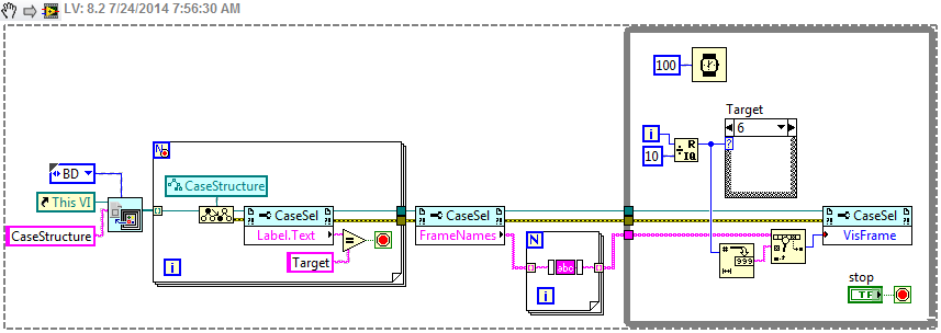

Is there any Way to find Which case is Executing in LabVIEW VI programmatically and Display it..

You might be able to adapt it to your needs.  The basic idea is that a custom probe on the wire to the Case structure's selection terminal sends a notification to a VI that displays the appropriate case.
We might be able to help you develop something easier if you'll give us more information.  Is it OK if the code to display the case is in the same VI?

This is what I meant by my question.  This code will keep looping and displaying the visible frame.

I'm sorry for taking so long, and for leading you down a bad path.  I forgot I had adapted this to work as a Quick Drop plugin.
Unzip the attachment into <LabVIEW 2013>\resource\dialog\QuickDrop\plugins.  Select the string wire leading into the Case selector terminal and invoke the quick-drop plugin with ctrl-space, ctrl-f, then run your program.

Accepted by topic author hameedkdnl
I just now published the Quick Drop plugin here - https://decibel.ni.com/content/docs/DOC-38903#comment-36562  There's more information on how to install/use it there.
