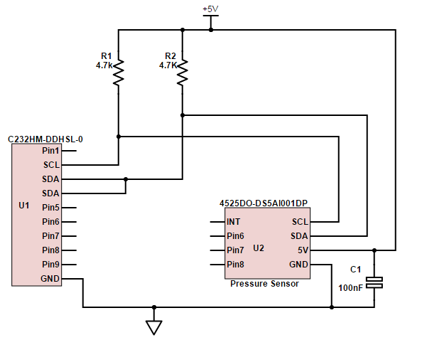

I2C communications using FTDI MPSSE Cable and TE Pressure Sensor
I have an FTDI MPSSE cable and a TE Pressure Sensor
FTDI provide LabVIEW drivers for the FTDI but I have been unable to detect a response.  My setup is as shown below.
I am using a 3.3 V FTDI with the 5V TE pressure sensor.  FTDI have stated this should be fine.
According to the TE specification:
The I2C address consists of a 7-digit binary value. The factory setting for the I2C slave address is 0x28, 0x36 or 0x46 depending on the interface type selected from the ordering information. The address is always followed by a write bit (0) or read bit (1).The default hexadecimal I2C header for read access to the sensor is therefore 0x51, 0x6D, 0x8D respectively, based on the ordering information.
I could not get the FTDI driver running so tried Benoit's driver: https://lavag.org/files/file/282-mpssedll-labview-driver/
However, there is still no response from the MS4525DO.
When sending 0x51 (1010001) with the stop bit enabled, the following appears on the scope.
But no response.
When sending 0x28, the following appears on the scope but again no reply:
zooming in...
I don't understand the leading pulse when sending 0x28.

Hello SeanJ,
I noticed that the FTDI manual mentions that it uses its application software to select interface mode (SPI, I2C etc.).
Are you able to configure this correctly?
Also, which version of LabVIEW are you using? I am having some issues with using the driver together with LabVIEW 2015 SP1, but maybe that's just my computer.
Have you seen the pdf attached with the driver called "AN_177_User_Guide_For_LibMPSSE-I2C"?
It describes the included VIs, and the error you are seeing is described as follows:
"Return code FT_DEVICE_NOT_FOUND would mean that the I2C slave didn’t respond when it was addressed and so the function returned before even beginning any data transfer. Typically this would mean that the address passed to the function was incorrect, or the address of the I2C slave has been configured incorrectly(i.e. if the slave allows it), or the I2C master and the I2C slave isn’t connected properly."
In the function "I2C_DeviceRead", what number and data type are you feeding into the deviceAddress parameter? Are you providing the number as 0x28 hexadecimal or 40 decimal?
When initiating your channel, what are you providing in the ChannelConfig input?

Hey Benoit,
Thanks for the response. You are correct that the DLL and associated Labview code works. I ran into an interesting issue where it didn't work on a particular Dell laptop that I was using, but the same code and DLL worked on other computers. Not sure how/why that happened, but it was a very frustrating problem to encounter.
Message 6 of 11
(9,259 Views)
I'm glad to see that it worked. Concerning the DELL laptop, be sure you use a USB 2.0... It might be the problem....
Benoit
Message 7 of 11
(9,253 Views)
Benoit,
You are absolutely correct! I just got word back from FTDI. Turns out that if you have Win7 and using a USB 3 port, the DLL will not work, but it will work in subsequent Win OSes (allegedly). I'm going to update my OS and see if it works.
So, if anyone runs into this problem, this may be your issue.
