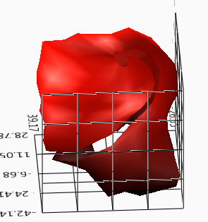

Hi, I'm working on a similiar project here and was wondering if the surface graph could be used to build a 3D model based on a cloud of XYZ coordinates. Also, I'm a bit confused about the Z- axis array. Is it possible to explain this in a little more detail?
04-18-2013 01:36 PM
Oh yes, If I'm not mistaken the 3D surface VI has 2 modes. one for vector and one for matrix.
If i am not mistaken, XYZ coordinate data are in the form of matrix, right? Wouldnt the data output be a different when we use the vector to build the 3D surface?
04-23-2013 12:09 PM
I linked the point to the 3D scatter, and they look perfect!
I tried using the prescribed method to form a 3D surface between the points but somehow the 3d surface was not formed as planned. Its just a plain sheet when it should; when referring to the 3D scatter, form surfaces connecting each of the points in the point cloud.
Did i wire 3D poly wrongly?
I've attached the coordinate data, the VI starts by loading the coordinate data first.

05-09-2013 10:34 PM
Hey guys, I solved my problem relating to the surface VI. It seems that i have mislooked upon the dimensions of my data. To put it in simple terms, the value of XYZ coordinates do not specify the dimension of your data. It is the amount of points in which Data is sampled along those Xand Y axis.
Simply put, how many data do you sample across the x axis and then how many data you ahve sampled along the Y axis? With that data, reshape the array for the Z coordinate according to the dimension
EG: I sample 12 points on the x axis and then 12 points along the Y axis so the dimension for the Z matrix must be a 2D array of 12x12 size.
The same goes to the parametric surface. Both X,Y and Z 2d matrix are actually arranged according to the dimension in which the data was sampled! With X any Y sampling dimension (Not the value of the X and Y coordinates!) as reference to the array size!
Thus using the example above
X,Y,Z matrix = 16X16 2D dimension array
i and j in the help file actually refers to the dimension size! Not the coordinate positions!
So for my case, i got my image.
I got the 3D image from the 3D parametric graph.
So in point terms
1) Identify the dimension of data
2) Identify What type of plot do you want? Generally surface graph VI plots surfaces, parametric is better at plotting 3D images
3) Build the 2D matrix according to your dimension
4) Run and enjoy the image.
This might not be a good guide, butI hope this helps others who are plotting a simple 3D image from coordinates. =D
