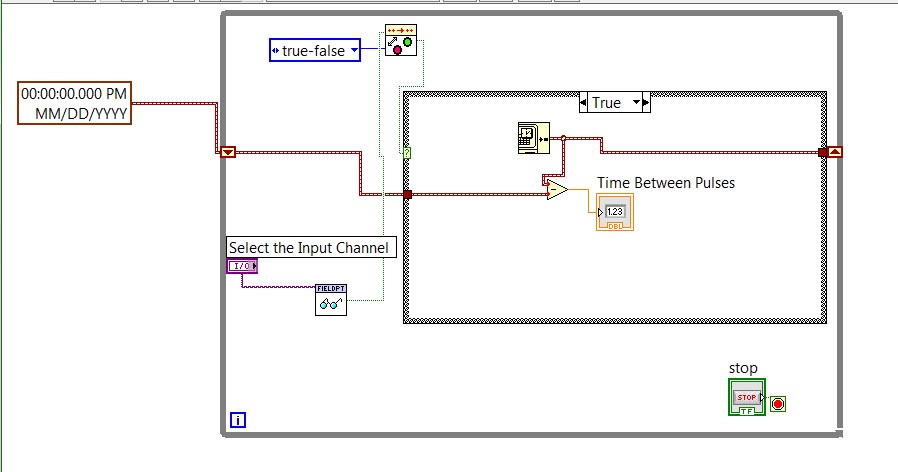

How can i measure the time between two successive rising edges ,using digital input ..
yes !! ,when i did the mechanical action thing ,it calculated the time 🙂 and I can't understand why 😄 hahah ...thanks chrissy
Now instead of the bolean button ,im going to wire a digital input ,how does the mechanical action thing can be applied in case of the digital input ?

I'm glad it worked! You should take the time to understand the mechanical actions of buttons - it'll pay off later.
In your main program you'll need to wire the boolean output of your detection subVI to your timing case structure, so that whenever a rising edge is detected the boolean goes true and the times can be compared.
If you post your subVIs as well as the main VI we can debug the whole program.

as you do not have a hardware counter in your system.
So your time measurement is software based. the accuracy of your solution depends on several factors.
Your FieldPoint System, Host PC and all the background tasks of windows that can effect your result.
Maybe you can give us more details about your system.
As an attachment you can find a possible way how to measure the time between two rising edges. (software timed only)
So the results may vary depending on your system.
I described the different parts of the expample with labels. The for loop is used to generate a simulated digital siganl.
How can try to replace that with our digtal Signal of the FieldPoint.

Hello Guys
When I removed the boolean control (In both Chrissy's and Andreas's VI's)  and wired the output of my FP READ Subvi ,the time was always zero ,I thought it was because of the mechanical action thing that the output of the FP Read did not behave like it did ..so I made some modification that I wanted to show to you coz it actually worked.
I used a subvi Name " Point By Point Boolean Crossing" and I wired it right after the output of my fp read in order to detect the rising edge and triggeer the True or False Case Structure ,...I'm glad it worked 😄 ,although I cannot fully understand why it did in the first place 😄 haha.
Anyway ,I thought I'd have to share it with you 🙂
