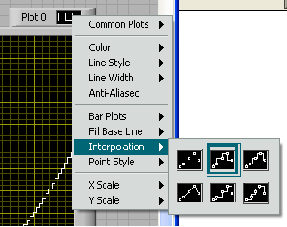

I am trying to plot an xy-graph, such that the data points are plotted as circles and connected by lines that stay horizontal at the level of the data point and then go up vertically at the next datapoint. In the properties menu for xy-graphs this options is given. However, it is grayed out and I don't know how to activate it. Can anyone give me a clue as to why this is? I put a red rectangle around the options that I am referring to in the attached screenshot... Thank you!

You need to right-click on the Plot on the legend (on the front panel) and select Interpolation. That displays a submenu of the available choices, with the one you want. To be honest, I'm not sure why the Properties dialog does not allow you to select the Interpolation style.

Note that you can also change this setting programaticly using a property node.
This is apparently a bug (verified for 8.0 and 8.2.1). It has been fixed in LabVIEW 8.5.1. Time to upgrade. 😄
(In any case, it is just a UI issue of the properties dialog box).
One problem is the fact that you have little control over the circle size. You can increase the size by increasing the line width, which gets ugly quickly. 😉
If you want full control over the circles (color, size, linewidth), use the "plot images" overlay feature as in the attached example (bottom graph).
