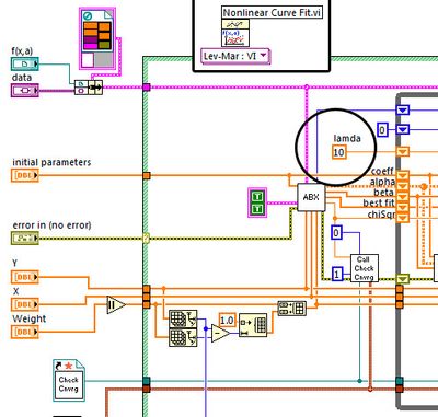

I somehow became suspicious when I realized, that the NI-LM-function starts with a lambda-value of 10 whereas in "Numerical Recipies" a start value of 0.001 is recommended.
I guess, the person who coded the function recognized, how slow his/her function was and "remedied" the error partly by increasing the start value of lambda to 10. Luckily and as the search is iterative, the function finds the minimum with acceptable precision, but is about 10 fold slower than the standard LM.

Thanks for raising these issues, they are important!
I just went over my copy of numerical recipes and you seem to be right with respect to the starting lambda and the formula to get the new coefficients.
I frankly never use the dedicated fit VIs (e.g. exponential fit), because I always write my own model, even in simple cases.
In any case, the Levenberg-Marquardt implementation in Nonlinear fit needs to be investigated, especially with respect to the speed of the convergence. The current nonlinear fit implementation does correctly reproduce the NIST test dataset, so the accuracy should be OK.
I implemented a test and your modifications (starting lamda, get new coeff) does speed up the NIST example quoted above.
Old algorithm: 5187 function calls
New algorithm: 3016 function calls
The results are identical!
Another small difference between the current LabVIEW implementation and the Numerical recipes book is the way lamda gets scaled:
LabVIEW: multiply by 10 or multiply by 0.4
Book: multiply by 10 or multiply by 0.1
Just wondering why the difference...
