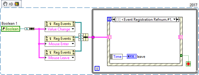

In my latest project I tried to streamline some dynamic event registration with control reference clusters and I just can't find an explaination for this behavior.  I have a sufficient work around and I'm only looking insight into why this is behaving this way I just can't do the things I want to do.
Issue:  When dynamically registering a cluster of control refs to multiple events in a single event registration node, only the first event is properly handled.  All other events assocaited with the same cluster of refs register and trigger but the event structure subscribed to the event reg shows the event as (unhandled) even if there is an event case for that particular event.  I can multi-register a cluster of user events and a cluster of control refs sucessfully (not shown in the code below).
Here's the code that works.
Here's some that doesn't.  Only value change event case is handled.  If the order in the event reg node is changed the top event is always handled.
A less desirable workaround (not as flexible for me and without strict typing on the second bundle, the event case names can get pretty long)event_reg_ewgo.png
My apologies if this is documented somewhere and I missed it but if anyone want's to try and explain this I would greatly apreciate it.

Based on what you have shown to work and not work I would suspect that it is a bug. I could not find a CAR tied to it although I didn't search too hard (I'll search more tomorrow and ask around).
It also looks like arrays of control references work fine if that would work better for what you are trying to do.

Thank you Jacobson for taking a look.
You are correct arrays do work for multiple registrations but that means all control events will be handled by the same event case.
I tried one more configuration and it appears to not be an issue with different clusters, only clusters containing the same reference.

What if in the first one, instead of having one Boolean1 reference being split, you have 3 different reference constants that all happen to be boolean1.
My thought is that you have a single reference.  For some objects within LabVIEW, you can have different references even though they might happen to all point to the same object.  I'm wondering if that same scenario would apply here, where maybe it would work if you had 3 references to the same control, If they'd have different reference numbers, but point to the same object.
I think I follow you.  This code passes just as does the first image in the top message.
However, if you bundle each of those, the situation is similar to case 2, unhandled events in the event structure.

Filed CAR 654057

Accepted by topic author deveh
CAR 654057 was fixed in LabVIEW 2019.
LabVIEW 2019 Bug Fixes
