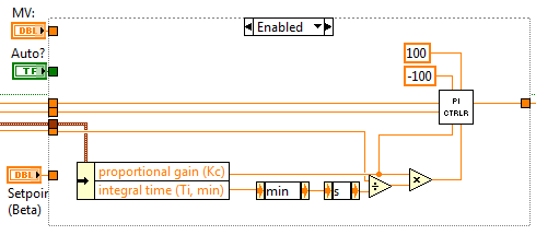

Barp,
Thanks for the reply and the examples. I don't think what you tested was clamping (conditional integration), but limits on the accumulator. I don't think clamping would have such dramatic overshoot compared to what's currently implemented. I tried out this implementation:
And got this result:
Compared to the PID that ships with LabVIEW:
Now that I've thought about it, I realize that what's currently implemented effectively resets the accumulator during saturation, whereas clamping does not, but it seems like that may or may not be desirable depending on your system.
