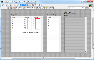

I've been prototyping some UI functionality and have run into a situation that consistently causes LV to crash.
1. Open and run the attached vi.
2. Click in the area highlighted by the red boxes at a rate of ~2/second.
3. Watch LV crash in 5 seconds or so.
 I'm running LV10 and Win7.

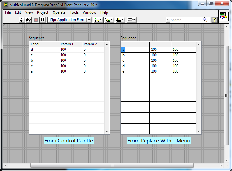

Thanks for the feedback.  It does appear to be an issue only with the MC Listbox from the System palette--I couldn't repro with the Modern or Classic MC Listbox.
I found another oddity... the MC Listbox you get from the FP System palette is different than the MC Listbox you get from the FP Replace -> System palette.  The listbox from the Replace menu doesn't repro the bug either.
I've also attached a revised vi with the simplest code that causes the crash.  It happens when wiring a negative number into the MCListbox.Value property node.
Message 3 of 8
This is incorrect.  All the settings get reset when replacing the control.  Once you set Allow Dragging and Allow Dropping the replaced system control crashes too.
