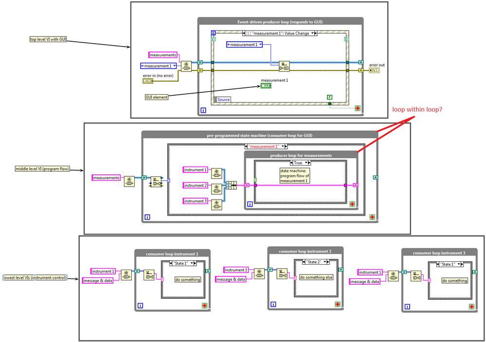

first thanks for helping me so far! I've got my program to run just fine, but before investing much time in the implementation of the GUI, I have an architecture question.
What I have right now are two levels:
  1. multiple producer loops (one for each program routine): state machines (with a while loop of course) that controls my respective program flow and order the instruments around. These loops do NOT run concurrently. It depends on what the user wants (he/she may not want to perform all measurement tasks and may select only 3 of 5 or so. They run sequentially
  2. multiple consumer loops: message handling loops that just act, one for each instrument/motor
What is missing: the top level VI with the GUI
I planned to drive the producer loops by treating them as consumer loops from the GUI-point of view. So they receive queued messages by the GUI and in turn enqueue their own messages to the instruments.
But:
Then I would have a while loop inside another while loop Isn't that bad coding practice? Is there a better way to do this with my current architecture?
I made a simple example VI of my architecture and a screenshot to illustrate.

There's nothing intrinsically wrong with having a while loop inside another while loop.  Sometimes new-ish LabVIEWers get themselves in trouble b/c of not really working through the dataflow, but the issue is not simply the existence of nested loops.
Your usage looks (probably) fine -- an outer queued message handling loop and an inner state-machine-like sequencing loop.  As long as you maintain awareness, as I think you have, that you can't receive the next queued message until after the inner loop terminates.
As shown, your lowest level is a very helpful layer of indirection to make sure the mid-level inner loop can execute to completion very quickly.  All it has to do apparently is fire off a sequence of messages to the queues that are serviced at your lowest level.  That'll keep the middle layer quick and very responsive to new messages.
Implied in this however is that the code at the upper levels never just sits around and waits for responses to the messages it sent.  Presumably, the lower levels will respond asynchronously at some point in the future.  Consequently, the upper levels need some additional logic and state-variable-like information to recognize when a particular sent message has been fully acted upon.
I've been using this kind of architecture more lately.  It seems like a lot of overhead when coding a simple system, but pays off well for larger, more complex systems.

I cannot view the VI (I'm on LV 2012), but one thing I don't like is what happens when measurement 1 is finished? I assume you want to use your 3 instruments for measurements 2 through N as well, but the instrument queues are stuck inside your Measurement 1 state.
Rather than using named queues, I prefer to wrap the queue functionality inside of an action engine. Each action engine takes care of 1 queue, and you do not need to wire queue in and out because it is held in a shift register. Then you can use your instrument 1 queue (and 2 and 3) in whichever measurement state you want, just make sure to initialize it at the beginning and release it at the end of the program.

Thanks for all the replies!
The inner loop with the program flow for the actual measurements is quick, but in an error case, it has to wait for a user input (signaling that the error is taken care of - it is a light barrier that has to be manually reset). Maybe I could change that behaviour somehow.
Of course I would use the other instruments for the next measurements, I just forgot to wire them in this example.
What I don't really like about this concept though is, that it is not really modular. If I want to add more measurements, I always have to modify the nested state machine. What I would like much better, is to have one state machine (that selects the measurement depending on the user input from the GUI) that is decoupled from the state machine that implements the measurement itself.
Is there a way to have them in some sort of parallel manner?
